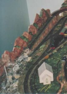

This is the rehashed area.
There used to be 4 turnouts there, with track crossover and two branch lines heading off to the bottom left (for extension). Too much squeezing twisting etc, causes derailments all the time, so I have replaced the area with just one turnout to bring the two inclined tracks together, and round the bottom corner. Left out the "extension" turnouts.

That pic may be a little deceptive. The lower left of the pic is already half way up the incline (flat area). The incline then goes back down to baseboard level, while the left most track continues on up the incline. This give the pic a sort of "double wammy" look to the incline. But the two mainline tracks are going down, while the leftmost track continues on up.:confused:
