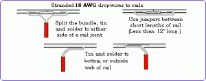

About rail joiners & soldering.....I noticed a few days ago that the locos stalled when entering one of the spurs in the yard at Portales.
http://forum.zealot.com/t159719/
This is track that's been recently painted & ballasted. I traced the problem to a joiner not doing its electrical duty.... So now I'm going to have to solder the joiner, or put in a feeder wire. I think the wire is the safest bet, as there is probably matte medium in the joiner....wall1wall1wall1:curse:
Try getting a small pair of needle nose pliers to the rail joiner and giving a little squeeze. This should crimp the rail-joiner and re-establish electrical contact with the rails.

I'd only bother to solder rail joints between sections of rail that are small. [Less than 1-foot long] Instead of soldering the rail joiner, I prefer to solder a small jumper wire between sections of rail.
The other reason to solder rail joiners is when you need to use multiple pieces of flex track to complete a curve. Putting together 2 pieces of flex track with a rail joiner and trying to curve it tends to result in kinks at the joiner.
