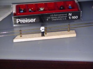

While there, I checked out their model ship detail parts: I purchased a couple sets of stanchions and some thin brass rods to see about making my own railings, here are the results:

The rails are composed of STANCHION, BRASS 2 HOLE 8MM 4 PK in the "Stanchion" category...
And thin brass rods (you probably can get this from your LHS) but for me it was $1.09 for five one-foot pieces in the "Metal Rods, Tubes & Wire" category of the 1/32" thickness (I believe).

EDIT: By the way, even though I model in N and got the 8MM stanchions, they have a whole bunch of sizes suitable for HO and even O scalers :D
