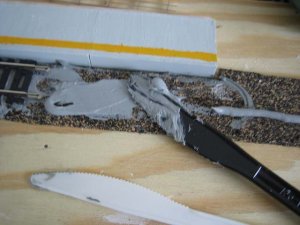

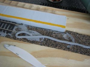

Photo # 2 and # 3:
Laying down a bead of the latex caulking, and spreading it out with a plastic buttering knife. The trick here is to make sure the caulking is REAL THIN. If the layer is too thick, it gets squished between the ties and leaves no space for the ballast.

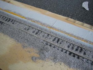

Photo # 4:
Sprinkling on the ballast. I used Woodland Scenics' fine ballast. The grains are all about 0.5mm wide, which translates to rocks about 2 inches in diameter in HO. It's actually a bit oversize, but I think it looks good enough.
The ballast is heaped on generously, then I use finger pressure to press the ballast into the caulking under it.

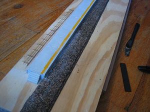

Photo # 5:
I then used a 1-inch paint brush to brush away the loose ballast (which by the way can be saved for use again later on). I gotta say I'm pleased with how it looked and how easy it was!
Before, I used to ballast using an eyedropper to apply the Elmers/wet water mix. It was tedious, it was messy, it took a long time.
To ballast the station module, which has 4 feet of track, it took me all of 20 minutes.
I think this is how I will affix track and ballast from now on. :D

Heya Ron,
The latex caulking I used is DAP's Dynaflex 230 (bought it at Home Depot), used for caulking building exteriors. It's a gooey paste when extruded with a caulking gun. Once it sets (takes a few hours), it becomes a rubbery solid (which has only a little bounce to it). It anchors the cork roadbed and the track very solidly-- No danger of it sliding whatsoever. :thumb:
I don't see any reasons why not to paint after fixing the track and ballast-- The caulking is waterproof after all, so the ballast shouldn't come loose. :cool:
