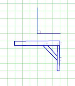

Prodigy, here is a crude drawing of how I build my tables, learned from a carpenter. Simple and very strong once together. I have more than once crawled up on mine to do something. The small dots are where screws go. The table is made out of 1x4s for the sides and 2x2s for the legs. For added strength you could use wood glue when you assemble. One thing I did not show, put 1x4s every 16" crosswise to fasten the top to. Reduces drumming effect and help deaden sound.

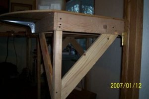

Prodigy, it's said a picture is worth a thousand words. Here you go. It's not pretty, but it's functional and can be hidden later. You can also see the cross pieces under the table I was talking about.
Loren
