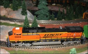

I run an Athearn AC4000 on my layout. My layout has 18" radius curves. It has never had a problem by itself running around my layout. The only issue I ever had was it would pull the car behind off the tracks around the s curves on my layout (I now know better than to do that). However, I put kadee long shank couplers on and even that is no longer an issue.
Included a picture so you can see it. You can see the track pretty clearly inbetween the trucks, so of course, it is up to you if that is acceptable.
