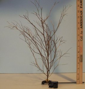

I don't have a timer on the digital, so can't set up to photo while I'm working, so;
After gathering natural materials, which bear a reasonable facimile to a tree, I added branches to what I had chosen as the basic "trunk". This tree is being built in O scale for the On30 diorama (see G/O/S scale: The On30 Conspiracy, page 4, and 5), it is about 64 scale feet tall, and the trunk is about 10 scale inches in diameter at the base.
The next step is to apply Woodland Scenics Polyfiber. The process here, will be to take small amounts of polyfiber, and expand them, to create the finer branch structure. For a tree of this size, I'm estimating about five hours of work. I'll shoot a couple of pics as this progresses, and one of the completed branches.
Once satisfied with the branch structure, I'll procede with applying leaves.

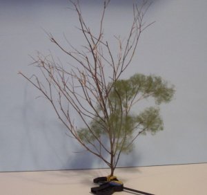

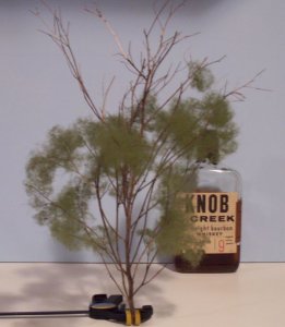

At the end of the second hour.......... if you "water" it, it will grow.
As each bit of polyfiber is added to the tree, it is further expanded, and shaped in place.

The "break-in" solution in back of the tree is a major necessity for all tree builder wanna-be's. It lets you see your work more clearly:D :D :D

uuuummmmm I guess the 2 hour mark is the "planted" stage of tree building:D :D :D :D

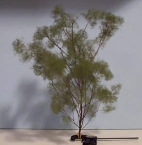

At the end of the second hour.........I needed an attitude adjustment break (hic) so. Next day, another hour, and the branch structure is done. The next step is adding the leaves. This is done, by spraying the tree with Testors GLOSSCOTE (yes,gloss),and then sifting Woodland Scenics coarse turf over the wet tree. The Glosscote is sticky enough to hold the fine particles, and doesn't "milk" up with multiple coats. This tree will take about five applications of glosscote and turf, and a final overspray of glosscote.

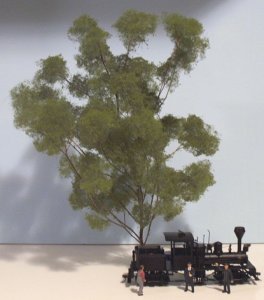

OK. It took about a half hour to apply the leaves. The whole tree took close to three, and a half hours to get the fine branches and leaves done. With about two hours assembly time of the basic "armature", the tree took about five and a half hours to build.
While O scale is "twice" HO, it is 8 times the volume, and consumed a large amount of polyfiber, and coarse turf. (and a lot more time too !!):D The picture shows the finished tree.
For my next magic trick, I'll get a rodent to stop smoking !, otherwise known as pulling a habit out of a rat.;) :) :D :D

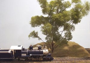

The last step is, of course, installing the new tree on the diorama.
A hole is drilled in the thin shell, and the tree is glued in place. Once the glue has completely dried, I will surround the base of the trunk with sand, and add thinned white glue. This forms a pretty solid base for the tree.
