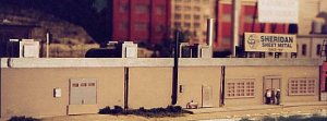

Thanks for your input...the folks at Sheridan Sheet Metal (Industry B) appreciate your replies! :D

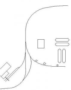

Here is a real life John Allen time saver. This is the track layout on the Reno Branch at the old station called Panther. It has a small run around and a total of five switches, just about like the time saver. I point this out for two reasons. The small run around was used to put a tank car ahead of the engine and shove it to a spur track around the corner about a 1/4 mile away. There was a second spur track but that one has been removed for over 15 years and I didn't show it. The track to the left holds tank cars of printers’ ink. A hopper of unknown contents is usually there also. On the right there is a track for unloading LPG. I show three towers, but now that the drawing is done, I think I should have put in a fourth tower. The switch around the corner is opposite of the two shown at the run around. The second reason is, if you look far enough, you will find a prototype for just about anything. :D

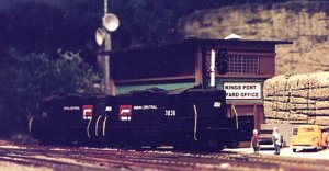

Well, everybody my crew is going to ponder your advice..but they best figure it out soon since they are close to scheduled departure time! ;)
