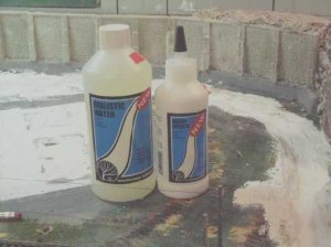

Thanks for the info guys,, I to was weary about this venture.
But here is the new water product.
No heating just pour, will set up to 1/8th deep and self level.
The smaller bottle is used for water falls and such,
check out woodlands web sit.
Cheers:thumb:

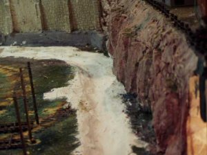

looking like a fine start Chris never used the new water stuff but have used spar varnish thined down with auto thinner for trickel's of water.:thumb:
as for a name looks like the little snake to me:D

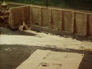

Hi Chris, I like your rock face and the stone wall looks great! A river along them will look super. I've tried the fishing line approach and wasn't too happy with it, tho that could just be me and givng up on it too soon. Doesn't mean others couldn't get better results! Also, I was trying for a short falls, not runoff from say storm drains. The WS water effects is what I wound up using, approach is detailed in the link Val provided. Thanks Val! Climax1880 wrote about using heat to ripple Envirotex, I think he is thinking of resin. I've never used resin but I think I remeber reading or being told that heat will cause it to ripple during setting. At the time I was told resins appearance was superior to that of Envirotex, but that it stinks up the house. So I went with Envirotex. Ripples are easy with Envirotex, but time consuming, read that link. One thing I hadn't mentioned in the previous thread is that tiny air bubbles get in the Envirotex from stirring. Careful stirring will minimize this, and using the flame from a lighter will cause them to disappear after pouring in the river bed. If you have a hobby torch that would be better than the lighter. Just hold the flame an inch or so over the bubbles and they go away. Be careful of course, but I had no problem with the foam or styrene bridges I was under!

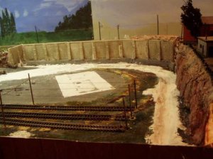

Hi Gary,, I printed out your step by step and I have it downstairs for when I am ready to test a few things,, Thanks.
Got to get the painting done first!!
The new stuff has to be max 1/8 in depth for it to set,, That`s the instructions,,,,,:D :D :D :D gonna bend that a bit:D :D :D :D
I hope to start the painting this week end.
I need a willow tree,,,, OOOOOO how I need a willow tree!!!!!
That would realy set that scene alive
:D
Anybody??????anybody?????:p :p :p :p
