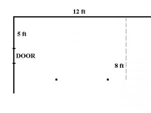

Modular does sound like a good idea. I think I have enough time before I move out to get up all the support benchwork, that way once I move out, I can work with all the lightweight stuff. I now know that I'm moving out sooner than I had planned, I'm getting an apartment off campus (which is much too small for any trains.. at all). The apartment is about 25 minutes from my current home, and about 10 minutes from my school. I would still be returning home almost weekly to do laundry and the like, and I also drive a pickup, so I think my plan is still feasable (that is if my girlfriend lets me use my desk as a modular construction site.
Anyways, some more details on what my plans are: I have attached a few images, one is of the area I have to build my benchwork. The 15' by 8' area has a wall along one length, and one width, with a door on the width side. The other width side is where some basement storage is kept, which has been slightly rearranged to allow access.
I was thinking for the benchwork (shown in the second image), three main sections, which I could divide into seven 2' x 4' modules. I would have a 8' x 4' main section; I would use this to set up the town buildings and large factory I currently have, also to make use of some of the 24 pieces of 22" radius curved track I have. Another section would be a 4' x 4' turnaround area, that would allow for some scenery, preferably a tunnel and mountain area. The last section would be a 2' by 4' connecting section, that would house a small yard.

What you are describing is sometimes called a "sectional" layout - designed to be taken apart from time to time. It is not a truly modular layout, in that it can only be assembled one particular way. One drawback to this is it is relatively inflexible. You will need to have a similar, if not identical space to reassemble it once you move.
I can appreciate that you want to use every available squre inch for trains (who doesn't? ;) ), but you might want to consider some other points. With your workbench and layout taking almost all the available room, do you have enough space for friends to help you run this empire? (Is that something you planned?). Do you have or need staging for running trains? Do you have or need additional storage, enough workspace, a paint booth, shelving, etc to fit in there as well?
As you have illustrated it now, I have a few comments:
1) In the upper left corner - that is a looooooong reach into that corner, for construction, righting derailments, etc.
2) Does the dashed line represent a wall, or just the limit of the space available. If it is a wall, you will have the same reach/access issues there.
3) I assume from the fact that you state "turn around areas" that continuous running is important? If this is just an assumption, have you considered point to point, or some sort of switching layout that may not require as much of the room?
4) What sort of track plan do you have in mind. This is really more important than planning the benchwork. How do you know that you won't require a triple-decked super empire to capture all the railroading you want to do? ;) :D
5) Related to (4), could you tell us about what era/location/theme/industries you have in mind?

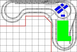

I do mean double track, but only in some places, the idea is for one track to run primarily hopper cars, and service a large cement plant I have built. The other track would service a few small buildings that are part of a small town (10 or so buildings) that I have. My main goal is to have two seperate trains, both running at the same time, with no switches needing to be thrown. To be honest, I want to sit back and watch.
I'm working with Atlas's track planning software, trying to use all of the track I have now.. a lot of 9" straight pieces, 18" and 22" radius curves, and a handful of switches, mostly left. I have finally got a tentative track plan drawn up. The inside track will run a short train, it's only a 15" radius. The outer loop will run the bigger hopper train, with the siding leading into the plant. The red is the border of the table, there will be access to the layout on all sides except the back (at the top of the drawing), the blue area is the small town, the green area is where the plant will be (it's Walther's Cornerstone Valley Cement by the way), and the remainder would be primarily landscaping, I have plenty of trees, and still have a full bottle of Woodland Scenics Realistic Water. What do you guys think of it so far?

Minor quibbles: There's an S-curve problem on the outer loop near the left inside corner of the benchwork. Also, any double-track layout should have two crossovers, one facing-point and one trailing-point, so you can transfer between the mains. I'd advise another crossover to the left of your current one - with right-hand turnouts. I don't think you need to bother with a separate runaround, since all spurs are trailing-point (assuming both mains are one-way).

If you move the current crossover to the right, and add an opposite one near the top left (as suggested by Triplex), you will create a good side runaround as a by-product...
