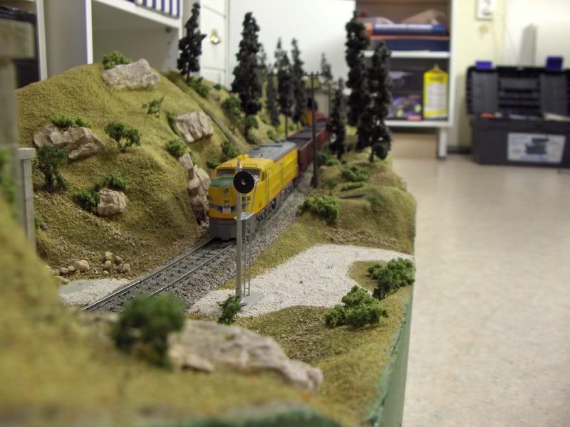

This spring a did a series of 4 modules that for my home layout would sneak around a table, but at modular meetings could be configured as need be. The short sides all have the same 'interface' (symmetrical along the vertical centerline)
They are all constructed basically the same way I did my first one, so it's not as detailed :eek:ops:. Here is the thought track plan for Märklin C-track
Tunnelportal and retaining walls from WS
The signal is a kit from Oregon Rail
