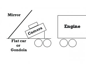

Here is one idea I had as far as looking over the top or along the side. Make sure that you position the camera and mirror so that when viewed it isn't apparent that you are looking at a mirror. Also that it clears all your underpasses/overpasses :confused: and tunnels. :eek: :eek: :D :D
Sorry for the crude drawing. :eek:ops: :eek:ops:
