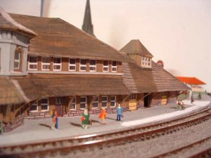

A CP station
Cinnibar
Nov 2, 2003
202
77
El Paso, TX
A Memory Sparked
What a neat picture! Back in ‘92 my wife and I went up to Chicago from El Paso on Amtrak. On the way back to El Paso we stopped at the San Antonio station. It was a cold, pitch black, rainy night but, since the train was changing crews we were going to be there for a half hour or so. We decided to take a look inside the old station. To our surprise it was completely renovated and very much warm and cozy inside. We got a couple cups of coffee and I stood in the doorway watching the crew and listening to those two, big FP-40's rumbling at idle. What an atmosphere...the cold, the rain, the FP’s, the station......never forget it! Your picture took me right back!:)

Robin,
That corner module is going to be a major showpiece!
That is some top-notch scratchbuilding,
my friend!
:cool: :cool: :cool: :cool:
