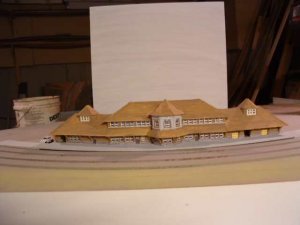

Here is the station set on the corner Ntrak module I am making.
The cork roadbed is in place so far.

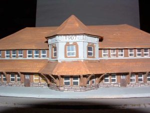

A close up showing the date of the building. That is the date on the prototype CP station in Saskatoon.
Some paint trim to be fixed still.

mhdishere
Feb 27, 2003
164
59
New Jersey
Robin,
I did something similar with shingles, but instead of using the sissors I used a couple pieces of scrap wood to hold the shingle strip in position on my chopper so that the near side of the blade (the part that doesn't usually do any cutting on the chopper) would cut the notches. Worked fine for me, and a lot easier.

Fred_M
Just a quick question, have you ever made shingles with pinking shears?
Matthyro
Will always be re-membered
Dec 28, 2000
4,551
85
Georgetown, Ontario,Canada
Yes I have dash10
but the size is too big for N scale but should look great in O scale
I tried one of those wobbly wheel cutters but it still didn't look quite right.
Now a thought crossed my mind that overlaying strips of pinking shear cuts may work. Will have to try that.

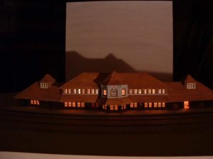

Night falls
The lights come on as the day ends. There are seven light bulbs in this station.
The backdrop just has a coat of primer on it as Spitfire says we will paint them when we get together next summer.

Lighthorseman
Jul 24, 2002
1,240
55
Out in the sticks
Holy Cow.
Amazing. Just, simply...amazing.
RailRon
Nov 23, 2002
1,602
Trimbach, Switzerland
Beautiful, Robin! Looks like it would be real cozy to sit inside that station and have a friendly chat with the station master.
I could imagine some white stuff around that station - from outside you hear jinglebells, and then from far away the lonesome wailing of a steam whistle! (Whoa - gets me goose-flesh! You really triggered my romantic vein with this pic! :D)
Just an idea: This could be a wonderful motif for a Holiday card (unfortunately without sound...)

Arlaghan
Sep 9, 2003
658
48
S. FL
Wow, I almost missed this one... I thought the picture before was the "I'm done" picture... glad I came back to look!
Looks incredible! I can already see the late night passenger train pulling with sleepy passengers getting off and looking around for their relatives. :D
