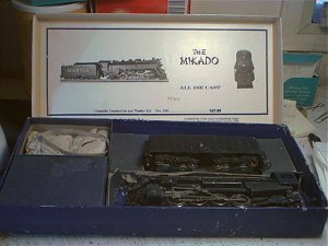

How old are they?..With an original price of $27.00,...They have to be old.
Can't wait for the finished projects.
I hope that big rubber band with the Mantua isn't the drive.........

The Mantua paperwork is dated 1955.
I paid less than the price marked on the box for the Mantua.
I haven't tested the motor yet but it doesn't look like it has been run much , if it has ever been ran?
I think the rubber band is for those Wiley Coyote thrust starts.
The Suburban is part of a deal I made with my brother to help thin out his collection of projects.

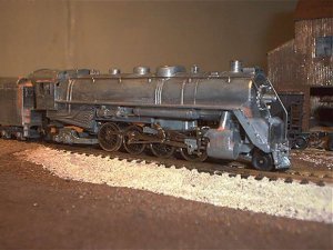

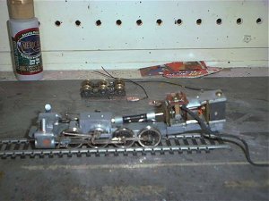

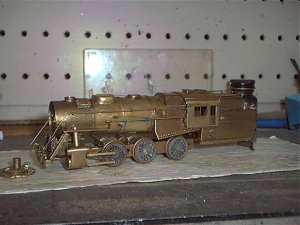

I completely disassembled the Mantua Mike and stripped the paint.
I had to repair the broken pilot and one of the brackets for the crosshead guide and valve gear.
To repair these I drilled holes for dowel pins and JB welded them in.
Missing spacers for one of the crank pins were fabricated.
I found some problems with the driver axle bearings that leads me to believe this loco has never been run. After reforming the bearings I have the mechanism running.

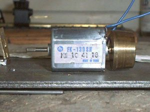

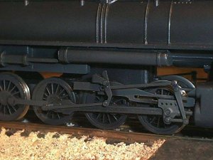

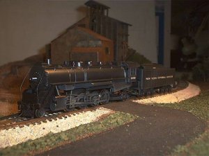

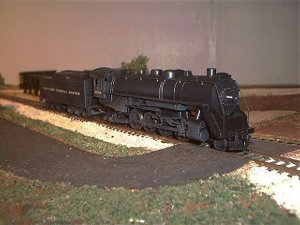

Once the running gear was debugged and running smooth I replaced the open frame motor wit this Mubachi motor with a flywheel.
I removed the boiler and painted the loco with the chassis assembled.

Can I ask how you get paint to adhere to the plating on the driver wheels and railings?
Ray Marinaccio
Aug 4, 2003
1,940
65
Dewey Az.
Thanks Guys,
The drivers get brushed with a fine wire brush before assembly and the railings I sand before I form them then wipe any oils from handling with thinner or alcohol.
The clear coat helps keep the color on them as it takes longer to wear through the clear before wearing the color coat off.

MilesWestern said:
What happened to that surburban tank loco, that was so cool! :confused:
I am waiting for the parts to repair my milling machine to come in. I was milling a new gear box for that loco when it broke.
I only have a few more parts to make for it after that.
