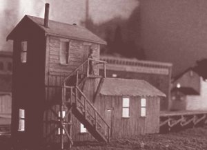

Heres another cardboard structure (N scale).
Built from a trusty Cornflakes packet and clad with handscribed 1/32" veneer.
Nothing fancy about it but interesting as a simple project.
I will attempt to insert here the link to the actual size drawings of the components. The drawing has a scale rule marked in feet so the drawing can be enlarged to suit HO.
Each corner of the structure has scale 8" x 4" basswood strips.
The chimney is a toothpick.

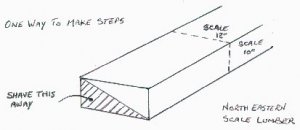

The steps were made by cutting scale 10" x 8" strips across diagonally opposite corners to form a triangular 'cheese' shape.
Errol
The finished article turned out like this:-

Glad you remembered that pic! It looks great! Man, making those stair railings in N scale would take some steady hands! Nice work.

Thank you for your wonderful comments my friends, I just wish I had more patience so as to produce a better model but in N scale, seen from 2 to 3 feet, it looks good enough for me :) .
Robin, I'm way too impatient to reach the quality of your card models. This took 15 hrs to make including the drawing.
Steve, You will make a much better job of it in O Scale, just don't forget to put in nail heads in the planking :) :) .
Belg, I saw your post in chat last night but it needed your query here to prompt me to show how the steps were made.
12" x 10" lumber is closer to real life steps.
Here's how:--

Fantastic!
I love what you've done! I am so amazed at what you guys can do with cardboard and cereal boxes! The lighting inside is a great touch.

My type of modeling !!!! I am certainly going to include one of the same (with your permision) on my layout
Great model and thanks for the plans I think Robin should start a "Society Of Cereal box Modelers" we all seem to have followed in his masterful foot steps

Dang Ken, you saw through it right away! ... Now I'll never live it down :) (but you sure know how to cheer a guy up :D )
Jimmy (and anyone), feel free, that's why I posted the plans.
Hmmmm, "Robin's Cereal Box Mutators Group" .... might work! how about it Robin? :D

Originally posted by Sir_Prize
OHH! Errol's yanking our legs.
That's a picture of his Great Grand Daddy at work.
That's a REAL building.
He did a photoshop on the picture to make it look new.
;) :D
Great work dude!
Yep, Errol, we've found the original!:D ;) :D
Seriously, friend...it is one fine piece of workmanship!
Beautifully done!

Aha, missed this thread, wow, thats one hell of a nice structure.
Now I just have to make me one of those for my 0n30 layout.
