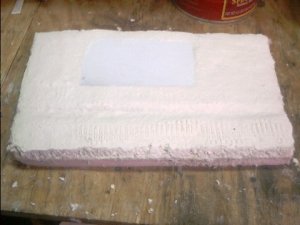

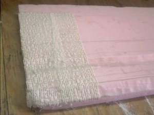

Next...I covered the foam base with Woodland Scenics Plaster Cloth. This will give the Sculpta-Mold something to hold on to(Try spreading Sculpta-Mold on bare insulation). After covering the whole base, I set it aside to dry.
Next: Foundation for the depot, and the messy job of appling Sculpta-Mold.

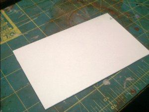

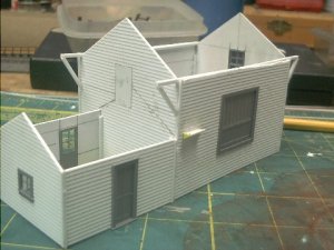

Today, I did the foundation, trim and roof supports and primed the depot.
First, I measure a piece of .060" styrene, keeping the edge as close to the loading docks as possible. After cutting the plastic, I checked everything.

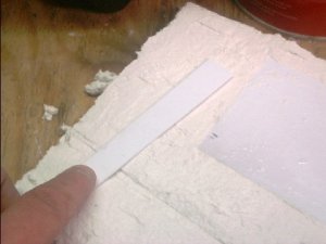

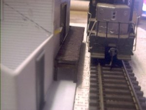

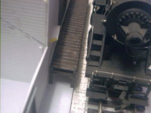

Next, I took measurements from the siding track for placement on the base. I checked clearences with both a steam loco as well as a diesel. I only did this, because eventually, it will be used on my layout(Yep...decided).

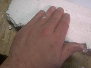

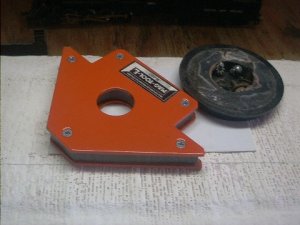

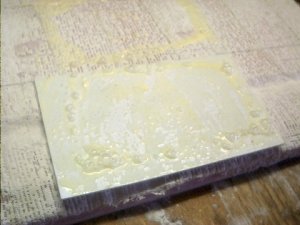

Happy with the clearences, using Elmer's Carpenter's Glue, I glued the foundation to the base. Weighing it down helps keep it down flat. Here I used two magnets I had.

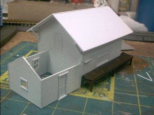

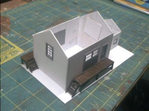

While I set that aside to dry, I went back to the depot itself. Using Evergreen .015" x .040" styrene strips, I applied the trim boards. I cut them longer than the walls, so I could trim them to size later. I also worked on the roof supports, using .060" x .060" Evergreen strip.
Here also is a pic of the trimmed, trim boards and the completed roof suports. I'm not worried about that boo-boo cut on the wall. It will be covered with trim board when I make the roof.

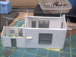

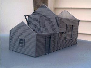

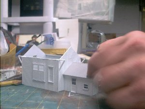

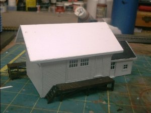

After the glue had set, I shot the entire building with two coats of primer, letting the first coat dry before appling the second. I always prime my models I'm doing, especially when doing white, because this will cover pencil marks, and any other flaw that happened during construction.
Next: Coats of white paint and maybe this time Sculpta-Mold....Maybe.

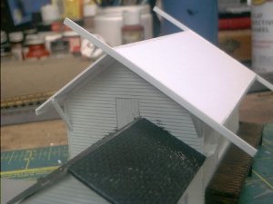

Next, I sprayed both panels flat black.
While the SA roof was drying, I went to work on the freight house part. Using the same method as the SA's office, and a .040 piece of Evergreen sheet plastic, I fabricated the roof for the depot. As with the prototype, this will be a rolled tar paper roof, which I plan on using the spray painted, masking tape method.
After the SA's roof paint dried, I attactched it to the model.

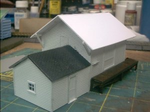

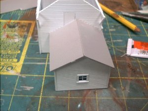

Next, using the same method as the wall trim, I applied the roof trim using Evergreen's HO scale 2x10 strip styrene.
Here's a pic with the completed roof trim. and a shot of the "blindside of the depot"

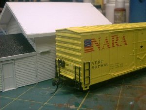

I'm so pumped about this project, I had to see what the depot looked like with a boxcar spotted next to it.
Next...Starting scenery on the base, painting the trim on the depot.
