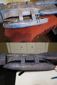

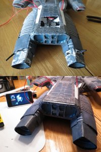

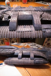

After nearly one month at the shipyard of the Scorpio fleet....:p
REPAIRS DONE ! :mrgreen::mrgreen::mrgreen:
See below for before/after interventions.
Now I can finish this baby

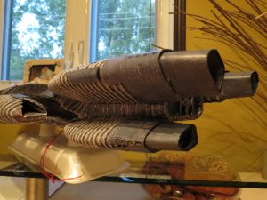

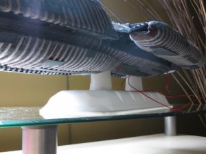

The lower left main engine is complet. I only have to fix it on the ship. More pictures to come.....
For the stand, I mounth something temporary made from recuperation things. First of all I wanted a diorama.....a big diorama but more than I look this stand, more I think I will paint it and keep it like that.
I don't know............I'm open to suggestions

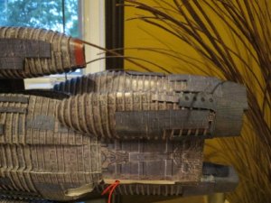

The bottom left engine is glued to the ship. The next step, the right engine and some adjustments and details.
Wen this step is finish, I will show you with the lights on.
Hope you will love it.....
