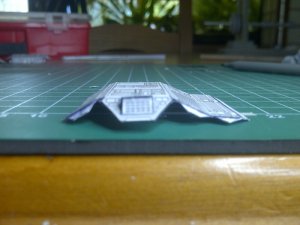

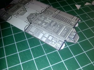

This was my first attempt at the 'air-con' units on the ends of ALL the modules on the spine....
Like I said; I'm not used to this medium, so it can be improved upon, I'm sure...
But, there again, in comparison to my nuts, which were never willing to get in shape..... (But, in hindsight, maybe I played with them too much and made them droopy and un-firm..... sign1 ), I found these little three sided things rather frustrating, because after I carefully cut, folded and shaped it, coloured the edges and then went to grab it with tweezers.....PING!!!.... There it went under the table...... My cat has a keen interest in my hobby, so, I have no idea were that one ended up....., or went....
Perseverance... And a true love of my cat... :)
I'm busy with completing the spine, and all the modules contained thereon, and won't bore you again with the repetition.... Of the linear spine.... And making sure it is all, well..... Linear... :)
Anyway, back to the air-con thingies..... Guess what... I'm gonna make a jig to speed up the process..... Somehow...

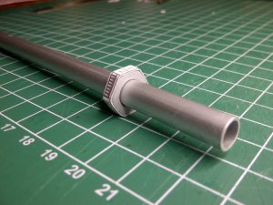

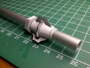

The M8 nuts that I used, instead of making the paper ones, turned out well.
The only slight problem was that I had to bore out the thread of the nut so that it would fit over the aluminium pipe. I also forgot to leave room for the spine wraps. So now the nuts are a very snug fit on the pipe,and are slid into there correct position and CA glued directly onto the pipe.
So, I had to make separate sleeves for the connector assemblies. These sleeve/coupling assemblies will then be slid on to the pipe and glued...

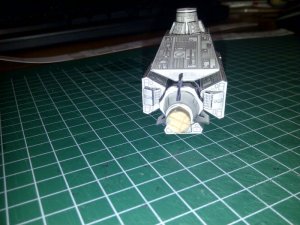

The same method I had to use for the central antennae module assembly, which is now complete, apart from the antennae array itself. I don't want to clumsily knock it off while I build the rest of the ship. The antennae array will go on last and become the 'crowning glory', so to speak.....

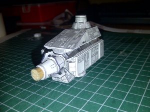

Update..
Been busy with other things in life, so not much progress it seems....
But, that is part of the frustration factor of this model; is that you put in many hours, and seem to get nowhere...... But, slowley, slowley it comes together...
The 'cartilage' of the spine is now installed as final build... The antennae module section is still not glued into final position onto the spine, as I want to leave this free for any tweaks that might need to be done, when attaching the modules to the spine nuts.....
The linearity seems to be coming together too ......:thumb:

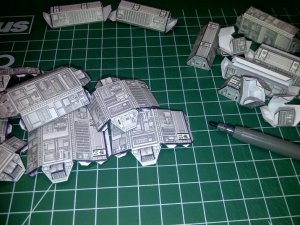

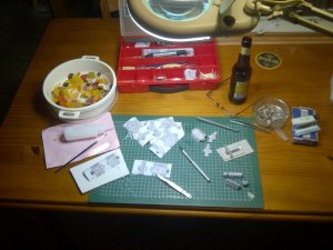

I think I have practiced and played enough, to establish a reliable production process, for the endless amount of modules to be manufactured...
The module production line ......With all neccessary equipment .. :cool:
Will keep at it...:wave:

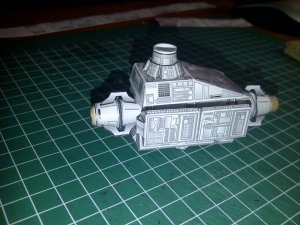

Visions?
At the beginning of the project, the nuts drove me nuts.......
Now, the modules are making me HALucinate .......
I'm seeing mini Cylon Fighters..........
Or, maybe it's too much to smoke.......sign1...
But, the boring build is continuing....:sleeping:

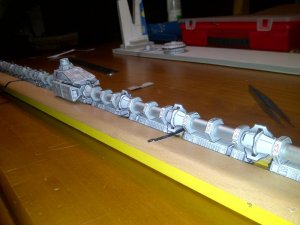

I decided I would build them in the sets of bottom, starboard and port sides.
Once each set is completed it can be attached to the spine in one go.
This should keep things linear ....

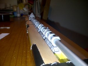

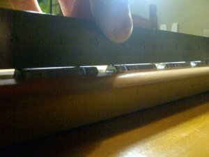

I decided on the level surface of the dinner table as a good flat base, so that everything can be layed out. (and now I can use it without any complaint :twisted:)

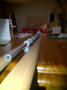

But, after wisely checking the surface with a 1m spirit level, I found that the table surface actually bowed downward slightly across the middle. Not enough that your peas would roll away if you dropped them, but enough to show up glaringly on this particular model. I needed as flat and true surface as possible. I pondered what, until I realized I was holding the answer in my hand; the spirit level itself!!!!

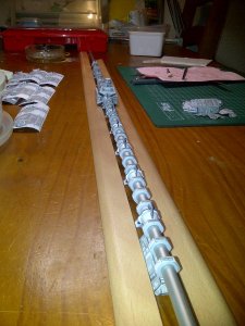

As was seen in a photo from an earlier post, I used two edging strips used in laminate flooring, as a straight edge, (I checked them first with the spirit level). These strips are thin enough to clear the bracket thingies on the couplings between the module assemblies, allowing me to snug the edge nicely to the widest section of the modules themselves.

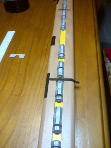

I used gaffer tape to hold one of these strips to the spirit level, ensuring it was straight to the edge of the level along its length.
I then placed 4 modules at intervals along the straight edge, and then placed the other straight edge strip on the opposite side of the other, with the four modules in between.
I then taped these down, while applying a GENTLE squeezing action across the strips. Now the gap between the strips match the widest part of the modules perfectly along their lengths.
I then placed all the modules in their respective positions and checked everything FOUR times, using strips of the spine wraps as measuring sticks for the module placement.
The photo should make it a bit clearer...
I sighted along the lengths of the modules to check trueness...
I noticed that the surfaces that mount to the nuts were not that level and a bit wobbily in places.
I used a light and a steel rule to check for trueness.... Plenty of light showing thru :(
To accomodate for this problem, I decided to use clear silicon as an attachment medium. This should help to eliminate any uneven attachment surfaces. So I turned the spine assembly upside down and added a small blob of silicone to the attachment point of each nut.
I then lifted the whole assembly and carefully, VERY carefully, lowered the spine assembly on to the laid out modules.
The weight of the aluminium tube and the metal nuts, should be enough to apply enough downward pressure as the silicon dries......
And here it is, in place, with the silicon drying....
