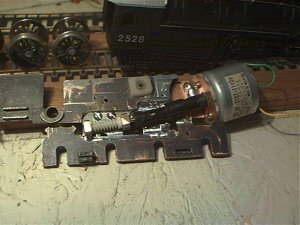

This is a common problem with early bachman locos.
Check with Bachmann to see if they can help.
I tried Loc-tite stud and bearing mount on one to glue it in place, it hasn't come off since, but I don't run it much either.
I repaired another by boring holes in the drivers on the lathe, installed insulators on half of them and installed them on a steal axle. I also regeared it too. Absolutely more work than the loco was worth, (just had to see if I could do it).

I opened up the under carriage and found the problem. The plastic doo hickies (or axle) that is supposed to hold one of the non-powered drivers had broken free of both drivers. I presume that it was somehow glued to the inside of the wheels, but since it was broken it was not holding them in place. So as the wheels turned, the first driver would sneak out of place and jamb up into the break rigging and throwing everything off as the rods are pushed further. I am hoping that by glueing the axle back into place, that it will fix the problem. I really like the engine, but I haven't been able to run it because of that. What kind of glue is best for gluing plastic and metal?
