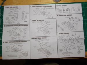

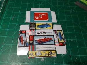

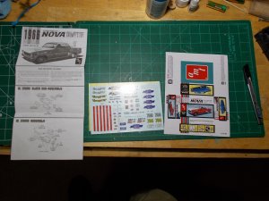

The instructions, decals to make "Grumpy's Toy" and a card model of the box in miniature...
ChevyII_04.JPG and three pics to show all of the instructionsChevyII_05.JPG ChevyII_06.JPG ChevyII_07.JPG

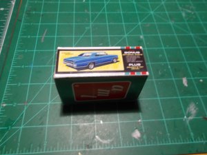

And a Quick build of the "Mini" box that comes with the kit.ChevyII_08.JPG Scored and cut out,ChevyII_09.JPG

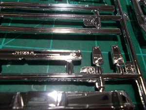

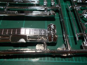

Hit a snag on my Chevy II but I shall endeavor to persevere. My 66 was not an SS car, but the kit has SS badges.
The Super Sport badge on the rear quarter panels is no biggie to get rid of, the SS badges on the chromed bumper / grill and rear trim piece would be easy to get rid of if I didn't care about the chrome...

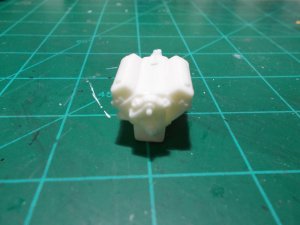

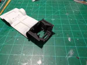

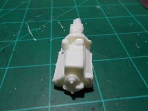

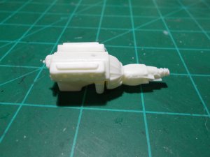

The build starts with the engine block so here are the first construction pics.ChevyII_15.JPG ChevyII_16.JPG ChevyII_17.JPG ChevyII_18.JPG

If you were very careful, you could modify the grill, then use chrome paint to remove and rebuild that area. In a worse case scenario, you spray paint all the chrome surfaces with a chrome pain./ Or, cut the grill out of that piece, and remake the open grill assembly. You could cut pieces from the "trees" and end up with a more realistic looking grill, or by thin styrene sheets to make the grill and spray paint with Chrome paint, which works and looks really great. :)

Might be worth leaving that alone, or coating it with Vaseline, and use it as a plug. Stick it into two part epoxy, let the epoxy harden, the grill will pull right out, because of the Vaseline coating, then you could modify the mold, and repeat the process using two part epoxy, coating the epoxy mold with a release agent (after you have trimmed what you don't want, and repairing any spots needing repair, or modification), then spray paint it with Chrome paint. Lots of work though! Might not be worth it. :)

I'm still in the process of chrome stripping, I don't have anything terribly caustic to use so it's a long process with simple green... I'll either repaint with "chrome" paint or try my hand at "Bare Metal" foil.

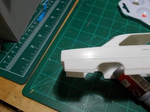

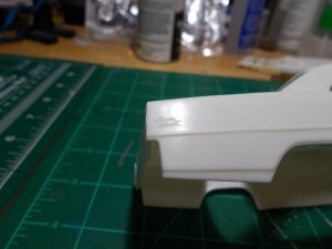

a quick update today, I got the Super Sport logo off of the rear quarter panels, and the panels sanded and ready for paintChevyII_19.JPG

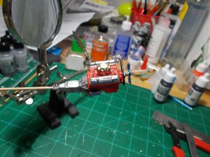

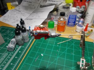

Work on the engine continues with the base Chevy Engine Orange laid down.ChevyII_20.JPG ChevyII_21.JPG
and the detail engine as it sits now waiting on plug wires.ChevyII_22.JPG ChevyII_23.JPG ChevyII_24.JPG ChevyII_25.JPG ChevyII_26.JPG

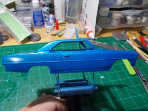

the body shell got it's first coat of color and it bubbled ARGHHHH now to sand the bubbles away and recoat.

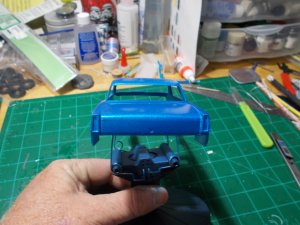

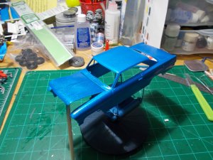

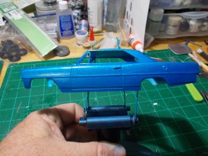

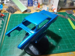

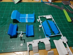

Plug wire kit is $6.99 and $7.00 shipping and handling. one place will do that one transaction the other has a $25.00 minimum order..... so looks like I'm skippin the plug wires. Got the body shell sanded and repainted, and color on the interior parts.
Since my Old 66 didn't have the best paint on it, I'm not gonna worry to much with the paint... I could sand it out and polish it to a mirror shine, but mine never had a deep shine on it.
so here are the pics of the color on the body. ChevyII_27.JPG ChevyII_28.JPG ChevyII_29.JPG ChevyII_30.JPG ChevyII_31.JPG

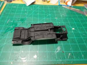

Engine looks great. Paint on car looks good too. Flakes are over exaggerated because of the flash. It looks great! :)

Thanks Z but there is no flash used in my pics... just my Ottlite workbench lamp with a Cree 60 Watt equivalent LED Daylight bulb, and Nikon CoolPix 16.1 MegaPixel camera.

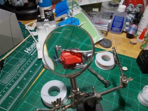

I picked up some wire at Radio Shack and am gonna try wiring my engine after all.
My first time adding spark plug wires to a model engine... the wire I bought, ChevyII_38.JPG
and starting by putting the wires to the heads...ChevyII_39.JPG ChevyII_40.JPG and yes I am working under a 3X magnifier.

The difference is the same. The lighting is exaggerated in the pictures, digital cameras seem to do this more than film. It looks great either way. The engine wires really make these motors pop. If you do the radiator hoses and fuel lines, you might get it to start!! :)
