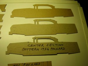

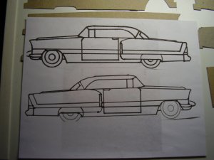

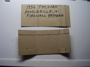

I have started a 1956 Packard Carribean Hardtop, about 1/20th scale (5/8ths inch to the foot). By 1956, the Studebaker-Packard merger was two years old.
My usual strip-and-panel construction. I have tried getting more accurate with my models, many times, but a lack of patience and proficiency in geometry gets in the way.
I finally realize that I like my basic method; its consistency, predicatability, simplicity, and its look. I've done so many models this way on the paper modeling forums, that it has become my trademark method. It's the way I build a car.
I started with an old magazine advertisement as the reference for my profile drawings and subsequent patterns.

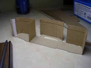

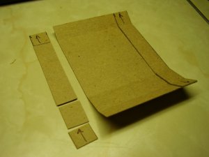

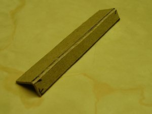

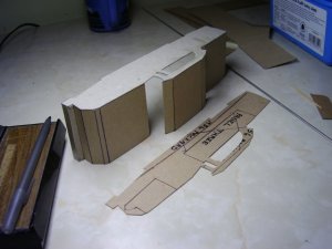

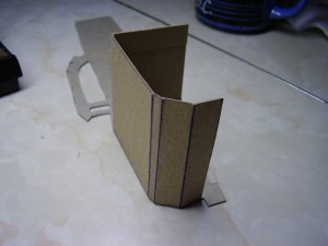

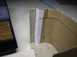

Now for the assembly of the center body section. You see why it's called strip-and-panel construction. The panel parts that you saw in the first post, are joined by strips. The strips for the center section are two and a half inches wide.
Notice the half-inch wide strips along the edges of the undersides of the strip parts. This makes the edges double thick for easy gluing. I don't like to use flaps for gluing; it's cumbersome, and can be sloppy, so I glue edge-to-edge, strip edge to panel edge.
When joining two strip segments together, as with the bumper segment to the grille segment, they are connected, by both being glued to a piece of paper.

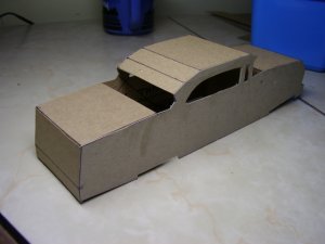

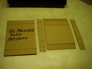

Now for the roof strip and trunk section strip.
After that, this subassembly is glued to the other panel

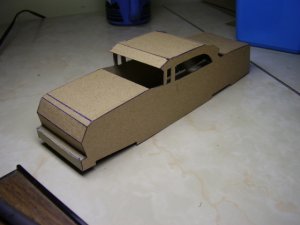

New center body section, with curves.
Mark Crowel
User of old school drafting tools; no CAD.
Jul 28, 2007
234
172
70
Southwest Michigan.

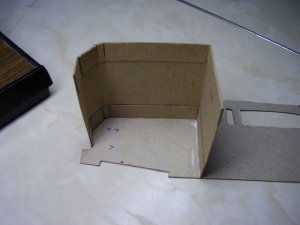

I was able to post photos from Photobucket, so now you see the curved surfaces of the new center body section, and what I have completed so far of the interior tub assembly.
