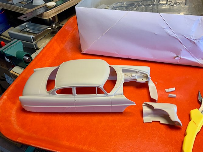

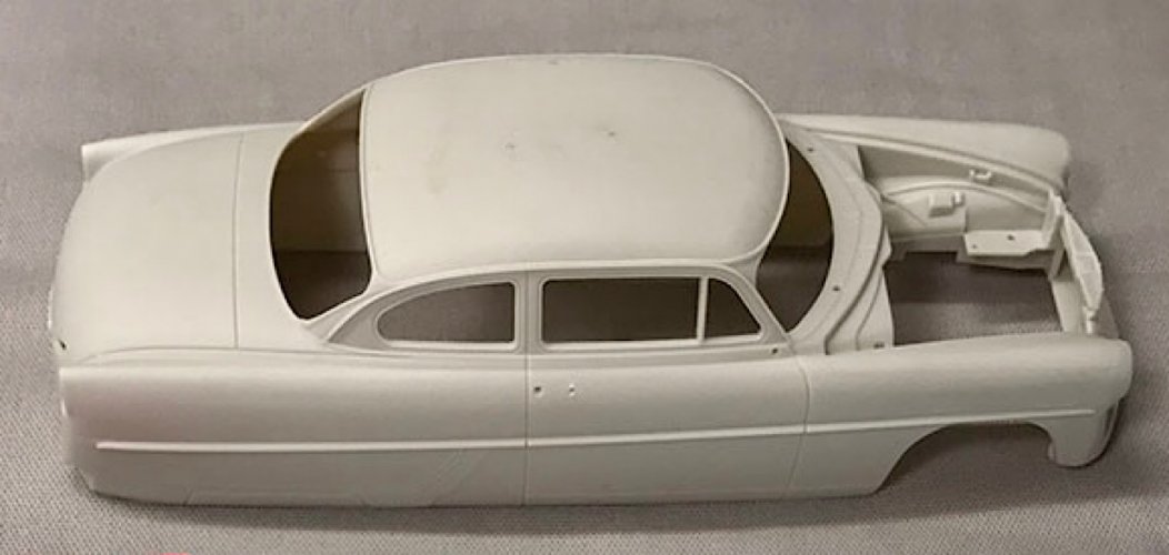

I got the model out today and was disappointed to find out that somehow it has been broken. The box was crushed and the right front fender is broken OFF!
The model:
And a pic of the body from the internet… like it should look.
Mine is broken at the top of the wheel well and at the radiator supports. I can fix it, but my styrene supply for reinforcing is not accessible. It is in a storage container that has about 4’ of snow in front of the door, so more must be ordered.

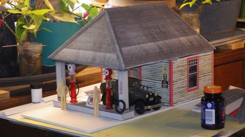

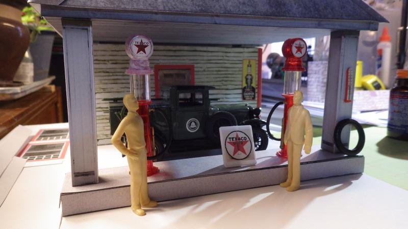

Last night I was looking through pictures and realized that I made a filling station diorama building years ago. It was for my 1:24 train projects. Hudson’s great great great grandfather had a filling station in Ohio in the 30s.
This is a picture of it, with a zoom in on the main part of the original:
Note the loading dock to the left of the building. That would be another item to model.
And this is the paper and foam board model I built. I think it is in a storage container out in the yard. When the snow melts down some (maybe by July?) I will try to find it and the accessories. I have quite a few accessories and people in 1:24 I’m sure.

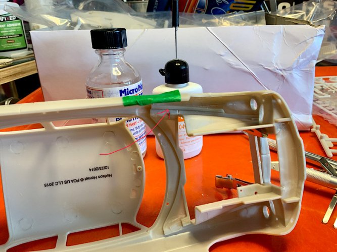

So I decided to use a piece of sprue from the model as a reinforcement in one place.
Here is the carnage. This was bad. The box must have been crushed and sat like that for a while. The plastic when folded and broken, stretches and it was a pain to make it all fit again. Thankfully, the fender crack itself wasn’t too bad, it was a fairly clean break. The other parts were a mess.

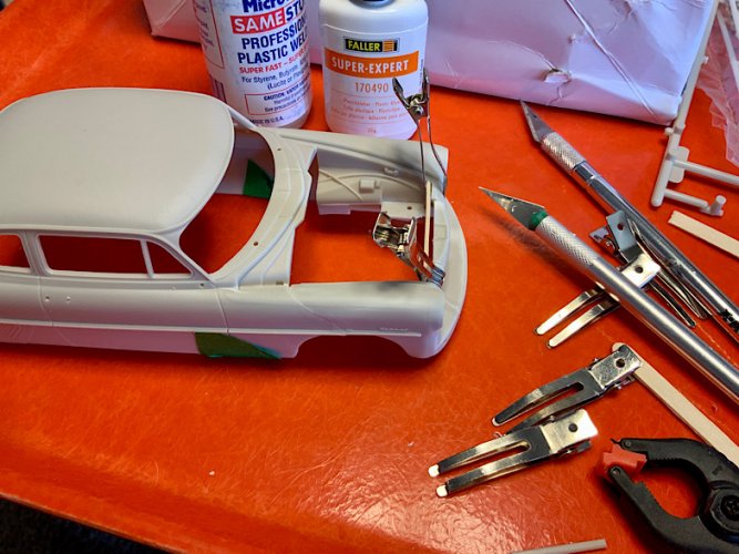

After gluing and before squeezing it straight. The cross members were the most work. The black haze on the fenders is a shadow.
The arrow points out the piece of glued in sprue.
This will work. Lots of stress marks and some sanding and fill will of course be necessary. I did find my sandpaper but am not sure what to use for filler. I don’t do styrene models much at all.

I use AV Vallejo plastic putty, it's an acrylic polyurethane resin impregnated with marble dust. it is water soluble while wet, and sandable, drillable, and tapable when dry.
