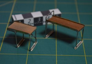

So...I did a bit of looking and found some originals and fabricated them out of wire and brass sheet, with veneer for the ply seat base,
in the process now of a canvas seat, cushion core out of Styrofoam so that it can be shaped and the canvas weathered etc..
More to follow soon...

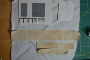

Thanks! All! In the proces of getting the seat cushions done..white fine cotton, weathered with a tea bag ( used, I won't sacrifice a fresh one for any-thing)!
Cloth-Sketch-Trash.jpg New cloth, then tea weathered strips Up Left-model driver seat (ackk) and a sketch for the shifter size and arrangement...

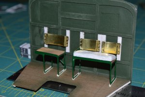

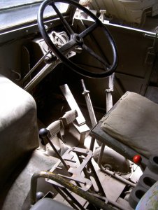

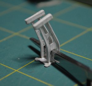

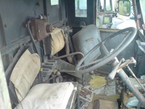

Found a few interior pix and noticed the seat back arrangement and the simple process of steel pin on the wall and set of holes on the seat back sheet metal to adjust the height of the back,
Seat-Build.jpg sooo.... made them up yesterday,...needs some paint and such, did not put the slanted sides on them but can change that easily enough..more concerned with the seat cushions for now..
Then I have to work on this bad boy...shifter arrangement lower center!
I have grave doubts as to it being shift-able, but depending on how I end up constructing it...it just might be...Why be timid now??

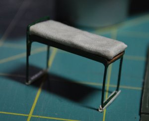

Made up one seat cushion for the bench seat, with the tea stained fabric...looks OK, but will more than likely add a bit more grime as the cab goes together, it is a wrecker after all!
Bench-seat.jpg ...under layer is a slice of Styrofoam, compressed to show butt prints..
Have to use eye-ball measurement and guess-ta-mation for the shifter arrangement..as I have Zilch for the measurements so used the height of the bench seat and artistic proportions to make one up...

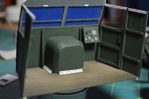

while was working on these things..had the cabin setting up on the bench, as I have started gluing it up. Got the floor glued in this morn...
Cabin-Glueup.jpg ...noticed also in the interior shots I found there is a transmission cover , this side of the engine cover, so will include that as well as the wood block foot rest for the accelerator ( anyone notice that?) also it gave me a few good views of the hand brake and other levers, so will work on those also...or to put in other words..start scratch building more stuff... next time!

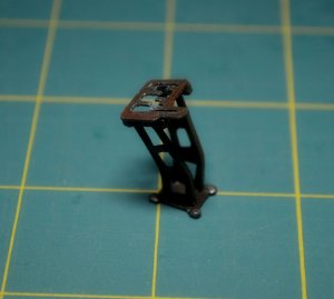

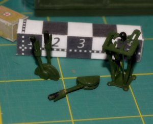

Still trying to get all the little bits and pieces for the interior done...here are some of the brake levers and the shifter tree, with prime coat...before final shaping and weathering..still have a few shifters to add to the tree, as well. Interior-Parts-B.jpg ..till next time..

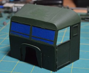

Little more progress...glued on the roof, and I must say " it was actually easy as pie"! not what I was expecting that's for sure!! Got everything ready including several strips of painters tape, pretested shape, did a little tweaking here and there and glued away! ....
Bit more sanding, and paint ( still have to decide if I am going to camouflage it with that terrible "Mickey Mouse " pattern ) !

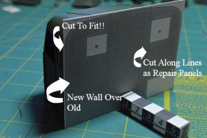

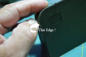

Then I did a test fit with the back wall...nasty nasty nasty!!! Another case of not so great design and my modifications! Might be OK with basic kit version ( I did check with Wak and the original Beta build...and it is also bad, they didn't fix things after beta build!!) problem is this...side walls are supposed to fit over back wall, but there are no cover strips so the ends of the side walls are exposed..since I thickened the walls as they were so wimpy, it now looks nasty!
I could glue and fill and paint but it will never look very good...at least not to my satisfaction! so...Here is my fix..printed up a new back wall to go over the whole thing...including the sides...then I can take the rivet strips that go up the sides and over the top at that edge and cover the edge of the new wall section, as it should have been to begin with.
I will cut it in 3 sections along the lines shown ( as repair panels, or as I have seen in some just the way some were skinned!) I can then cover those lines with rivet strips and be good to go! ( Hopefully ) !!

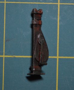

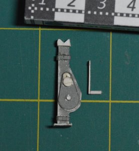

While being disgusted, frustrated and all that..worked up a standing jack...for the beast!
will put the handle on after jack has been sanded and painted...

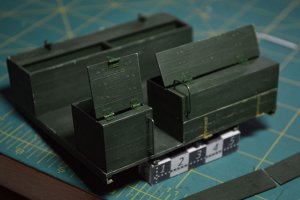

Moving along..trying to get this beast done...
I worked some on the rear box/ jib/winch area...trying to get the majority of it complete so it can go on as a single unit.....and of course started to run into trouble...the progress type...new changes/additions and the like...It is really a burden being OCD sometimes!! Anyway..decided to split the boxes on right side into two parts...couldn't see trying to open a lid the length of the rear area, as it was pictured in the model...so got that started..and also had to add more hinges... ..still have to figure a solution to replace the actual pin type hasp in the real thing..scale is just way to small!! Added some weathering to see what effect it will be..
