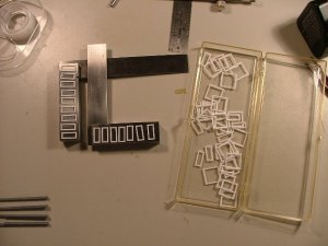

I've resumed work on my DSP&P paycar 051. My boxcars and waycar are awaiting super glue...so I've picked up where I left off a few months ago.
051 was built around 1879. I was paired with the office car 050 and commonly pulled by the roads only 4-4-0. The C&S rebuilt the 051 into a business car and she was renumbered 911 in 1911. The car survives along with the last South Park mogul at the Georgetown Loop. A brass model was imported a number of years ago by Hallmark...but it has many errors and is of the current business car setup...the worst error is that it is way too tall...but my dad picked up one of those for $20 a while back...so it is a nice reference point for my paycar.

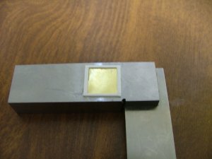

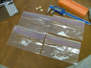

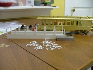

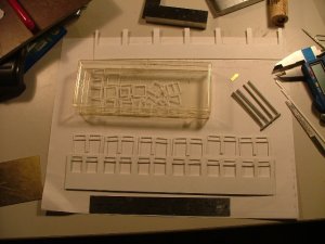

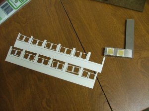

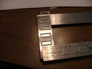

I've cleaned up the edges of the car sides...in preparation for the window assemblies. The car body is 36'2" long...my sides are currently 36'...but I'll will be shortening them to accommodate 4" corner moldings. I then spent 6-8 hours since Sunday afternoon building all 48 window panes...it's take over 500 pieces of styrene which I cut...and will actually be over 700 pieces once I've added the frames. The window panes just need a little filing. Here are some pics...

That's a lot of work to make all those windows, but you are doing a fine job so far. How do you plan on making the roof?
Kevin
I'm planning to build a a skeleton of styrene...using a layout tool to cut any curves...and then to add a layer of 0.010 styrene over that...the styrene will be several smaller pieces. I'm probably going to develop a trick or two for the end of the roof (the toughest part)...and then I'll add an additional layer on top of the roof to make it thicker/non-translucent/more durable.

I've mounted the upper panes in the frames...and glued them together in pairs with a 4" board in between per the prototype.
I've glued half of these assemblies into one of the car sides...but won't have much of a chance for the next few days to do much.
Here's everything completed so far aside from the frame which is somewhere else.
Michael
