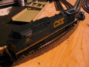

Here are some pictures. The atlas snap switch has an extra plastic piecewith screws so you cna position the motor farther fromt he tracks. this may be necissary if there is a tight curve ( like an 18" curve) at the entrance. this is because the Snow plow will often get caught.
The AC4400CW is also pushing it for what even looks realisitic.
THE C44-9W is the same size as the AC4400CW.
just take a look at these pictures and see if its worth while to you. a smaller locomotive like a GP38-2 or a B40-8 might be better.

Thanks guys, Thanks for the pic. Green_elite_crab. They are really helpful. I think if I add longer couplers I'll be fine. My switches are far enough away and they're Bachman, so there is no motor in the way. I am however, going replace the bachmann track with Atlas shortly, so those pic are a huge help. Thanks again:thumb: :thumb: :wave: :wave:

Scoobie,The coupler overhang looks like it would cause any following cars to derail..:(
Can you replace your curves with larger curves made from flex track?? IMHO that would be better and you should be able to use those long wheel base engines without the overhang.. :thumb:
brakie is right. it definitely will pull some cars over, even with a long shank coupler. it depends on where the coupler on the car is in relation to the trucks, but it seems to me that my tank cars get pulled off often, but some of my other cars stay on, even though they are more or less the same size.
