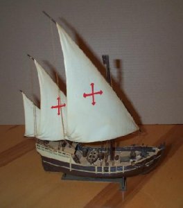

Few days ago, you asked about the sails. The cross have been sprayed with acrylic paint over paper template. Slawek also has send me very small tutorial as how he makes sails:
Making Convex Sails
Making Convex Sails
Hello Jerzy..
I know about the foam method, and was debating on whether or not to use it. Decided to give the paper method a try, and if I wasn't happy with the results, I would use foam on the next model.. I think if the openings between frames had been further apart, I would have used the foam. We will see how it goes...;-)
The tutorial on sail making is great, and that along with the other tips from that site will be quite helpful.. Give my thanks to Slawek. I appreciate both of you, for taking the time to respond..

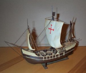

Here I thought of a way of getting my windows to have the "leaded glass" look that was on the printed part.. Used mesh from a sack that was holding some sort of veggie.. Cut to shape.. glued on the back.. painted gunmetal, and then coated with "Kristal Klear".. Came out better than I thought it would IMO.. Sort of getting ahead of myself on the build, but wanted to try this while the idea was fresh..

Back to work on this.. Have set the pieces for the keel in place, plus the upper first layer of planking. You can also see where I've sanded the hull to take out any humps before I start gluing up the outside planks...
