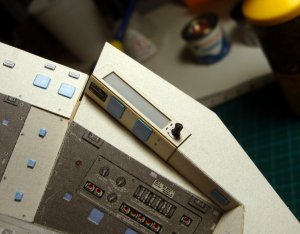

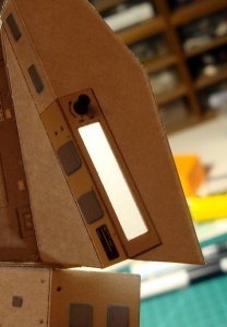

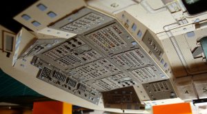

Ok guys... let's go with last panels batch. This completes the front section of the ceiling.
First of all the front side lamps. I'm not completely sure I catched the right shape. In the photos they appear to be separated from the upper side of the ceiling. Mine seems to be more "immersed" in it but the relative position to the rest of the cabin should be pretty correct.
Here you can appreciate the "backlighting effect" waiting for a little box in the rear side to limit light diffusion and avoid undesired transparencies.

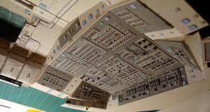

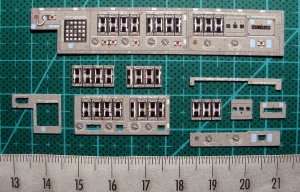

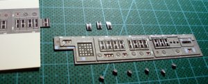

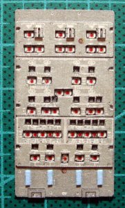

Overhead rear panels: O13 through O17.
The front panels are much more complex. Many details and more sub-panels to do.

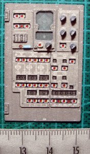

A first comparation between flat panels and the detailed O6 on the left.
...to be continued...

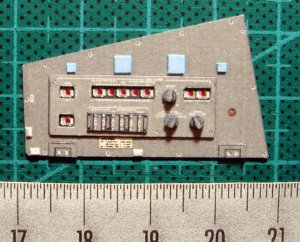

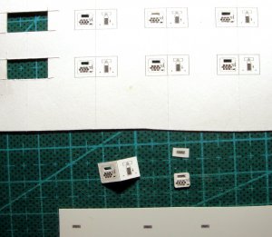

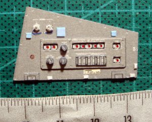

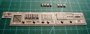

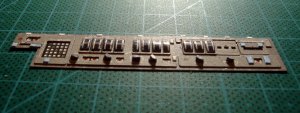

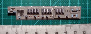

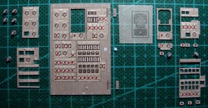

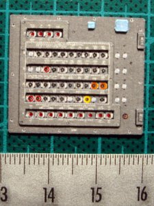

O8 panel components
and O8 finished

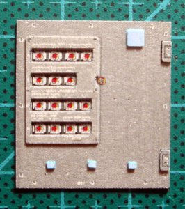

O7 panel

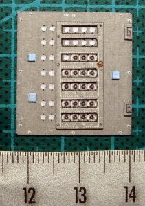

And now the audio panels for commander and pilot, O5 and O9

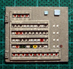

For the overhead front row I needed to do something different...
The pressure gauges have cylindrical front surfaces. The printed cardboard seems too flat and opaque if you compare it to the photos.
I decided to print the dials on photo glossy paper and give rounded shape to the resulting pieces with a knitting needle.
This way they are much more realistic
...to be continued ...

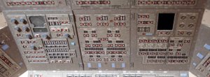

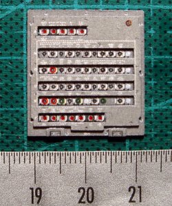

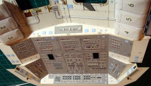

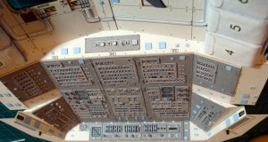

Now also the ceiling is complete...
Was all this panel work useful?
This is the flat - just printed - version...
...and this is the final - detailed - one ...
It was a hard work but the result is worth it... (not a good photo anyway... :) )

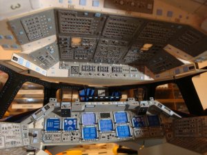

And, just to have a preview... a dry fit for the whole front section
Now I can start to mount all the sub-assemblies builded till here and finally give this project a definite shape.
But this won't be the final step... I still have an exterior side to deal with... :D

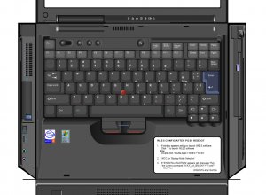

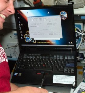

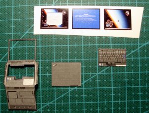

1) Laptops:
in all mission photos you always see plenty of laptops laying around in any free spot available.
This IBM papercraft is not mine, I had it in my collection for a long time. Everything can be useful sooner or later (I always have told you) so this time I had only to add Intel (TM) and Windows (TM) stickers and a mission label and the great part of the work is done.
For the screen I used the photo above, where the screen is reasonably square (photo taken at a low angle) , I straighted it a little and obtained a perfect copy of the actual STS134 desktop.

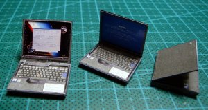

I also wanted to add a blue screen for a freezed PC (being Microsoft stuff I'm sure it happened sometimes...
...and here are my new laptops...

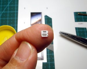

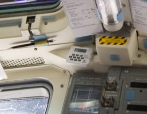

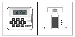

2) Timers:
you see a lot of them attached to every surface around the cabin. The astronauts were very concerned about timetables if they was counting seconds all the time.
This is a very little thing in 1:16.
I've found a photo showing the exact model they used and draw it carefully.
I printed the LCD on a separate glossy sheet but I'm sure the difference will not be noticed...
Anyway here is one of the littlest timers you have ever seen before
