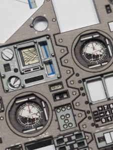

Yes, I have already bought a model on this site, but I still have questions for Ken. I hope to answer.

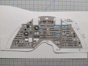

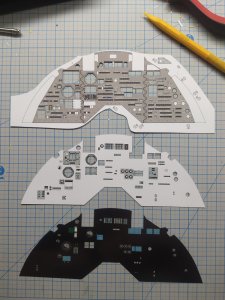

By the way, if anyone is going to build the model, the bottom layer of the main control panel does not exactly match the holes.
Before printing, it is better to correct the position of the elements or not to cut out the part and position along the holes and print. I discovered this after the start of builb.

I've never built this model. I don't know if printing differences, scaling, etc. can cause these kind of problems. I never trust a bunch of gauges to go on like that because I have never seen them line up right. Your way is best. :)
As I will return home, I will show what the problem is. There are minor shifts of screens in relation to the holes. This is not a problem of scale or print, it is the problem in the file. Perhaps this is a Ken's mistake.

Sounds like it. I built an ESKA Ekranoplan model I designed, and to give the "set back" instrument look with a glass cover, I did each one separately. Works out easier in the long run. :)

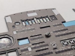

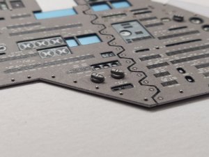

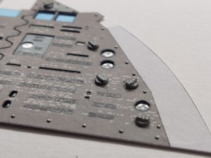

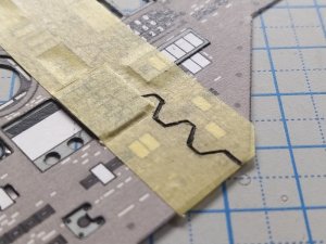

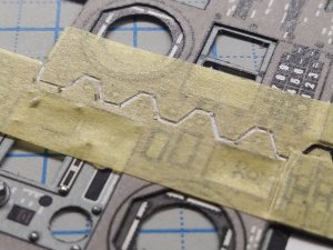

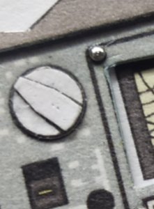

And it also seemed to me that the panel joint should look normal, and since 2 layers were already laminated, I had to come up with a way to style this joint. I used Tamiya's tape for protection, cut through the sheet slightly, and then scraped off some of the paper with the tip of a knife. Then I painted over the resulting groove with a liner, did not dare to paint it with liquid paint in order to avoid it getting under the tape.

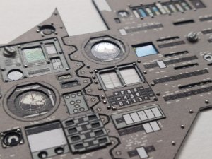

OUTSTANDING JOB!!!!! I'm gob struck by your ability to think outside of the box in this short period of starting this build. I'm thinking to myself if you have done all this with just one control panel what is instore for the rest of the other parts to come. Thanks for sharing with us the insight and your thoughts on how you see this model can be built and improved. I'm liking the journey you have started. Please continue.

What Scale is this? 1/12th? Daaamnnnn That is one tricked out panel. Looking at the end result I'd have thought this was 1/6th or even 1/4 scale. This is gonna be one hell of a model.
