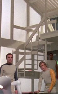

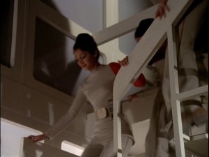

Hope your weekends were good. Mine was busy but I did manage to work on the stairway up to the mezzanine a bit... Nothing to show yet but as you can see by the attached photos; this thing is more like a post industrial sculpture.
It's really just a collection of thin, steel beams that the art department obviously tried to make as attractive as possible. The stairs seem to be welded onto the cross beams from the sides (sometimes on only one bar!) and the banisters are likely wooden boards shaped and painted.
The R2/MPC kit has a spiral staircase (No idea why other than it was slightly less complicated) so a more accurate stairway wouldn't even fit on the model. Fortunately for me, I've been able to find good photos of where the framework attaches to the set walls. This is giving me decent measurements and structural design. It will be relatively easy to build out of square styrene rod but it's going to be a pain to do in paper...at least in 107th scale.

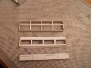

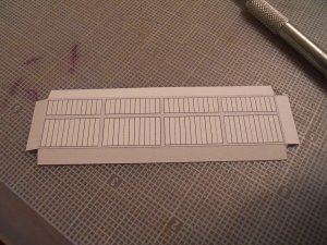

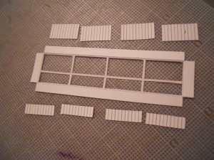

I also did a little work on the back walls of the mezzanine this weekend. There are panels from the floor to the big, slanted "picture" windows and then what looks like some kind of air conditioning above that. On the scratch build there will be window wells and ten slats for each compartment of the AC overhead thing. The slats will be pretty thin so you can actually see the model through them. I cut out those sections for the study model.
I also cut out the windows. All of the windows on the scratch build will have wells (more like tunnels to give the impression of depth), the idea being that you can see the model through the roof and window.

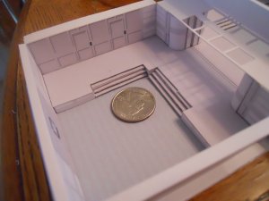

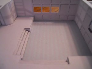

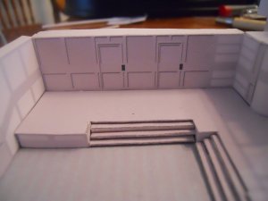

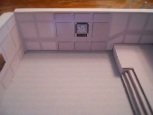

Still working on the stairway but in the meantime, I've installed the office walls.

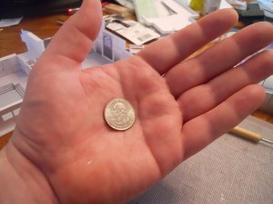

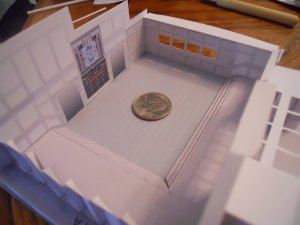

Honestly, the biggest difficulty with this effort has been the scale. The following photos show and American quarter dollar coin for scale
...and this is how big the hands of your humble builder are...
Needless to say... doing this is a lot like trying to thread a needle with jumper cables!
More later. Have and excellent evening!

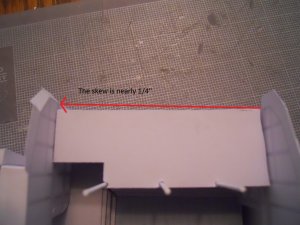

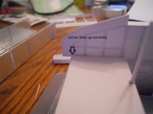

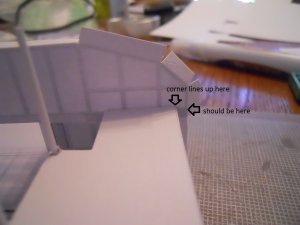

Well...

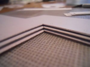

I was getting down to installing the mezzanine when I found out where the misalignment is. I was a builder for a while so I know that a miss measurement of a fraction of an inch will show up as a much bigger skew somewhere down the line. This one is pretty big. Glad it happened on the study model.
This happened because I glued the computer wall to the floor first. I should have glued both of the main walls down first and made certain they were aligned properly.
If I force the misaligned corner into place, it bends the walls rather a lot and will definitely pull the columns out of place... I'm thinking I'll just glue it as is and live with the error. This is what I get for
not taking my time. :hammerhead:

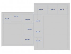

The new "lower" floor has placement marks now. This should do the trick.

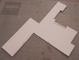

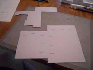

Okay!
Starting from square one again...

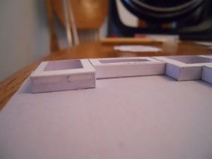

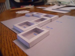

The new floor templates are cut and trimmed. Note the box numbers on the main floor. I really just winged it last time and paid a price. This time, the floor will be supported equally and there will be firm edges for the walls to connect to.
The upper floor with the first steps of both rooms folded over and glued with center pieces to bulk them up to the right thickness
Some of the "boxes" have artwork where necessary while other serve as support.
The top of the box supports have cutouts so I can adjust placement and burnish down the glue tabs.
I redesigned the stairs and numbered them very carefully. I'm installing them one tier at a time so they meet at the proper 45 degree angle. They are a great deal stronger and more consistent than the last attempt.

Still working on the floor. The only real problem so far is that I put the floor support boxes a little too close together and I'm having to trim here and there but it's otherwise moving along as expected.
