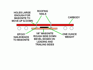

I have read probably every track cleaning thread here at the guage so I know how to clean my rails quite well.
What I am actually asking about is where I can find a soft pad style cleaning car like the Walthers 40 foot boxcar with a bright boy on the bottom.
I have the bright boy version of the walthers car but I am wanting to set up a "cleaning train" that utiliazes a bright boy in the front with a wet pad following and a dry pad after that .
I could kick myself for not buying the Caboose I saw at my LHS two weeks ago that had exactly what I was looking for on it.
What I am actually wanting to do possibly is make a MOW train that is my cleaning train. I may actually make my own if I cant find one commercially made.
It would not be hard at all to kitbash myself a few Blue box kits into a MOW train to clean my track after all.
