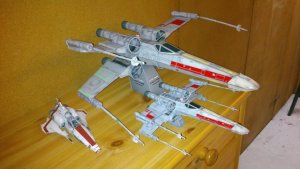

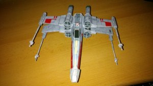

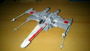

Hi again,
@Itzealot: yeah x-wing is intimidating - should be, espesciallly with wings open in battle mode.
As promised some pics to see the size again. Not totally finalized - I will take some colour to eliminate the white spots.
