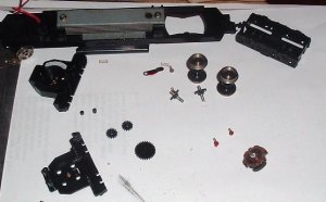

  17. shaygetz
    shaygetz Active Member
    May 2, 2003
    3,656
    By golly I gotta problem. It's all apart but....I forgot how it went back togethersign1
    The problem was a well used mechanism, the brushes were worn near to the nub. Found some that fit, put it back together with a bit of grease and oil and...woo hoo:thumb: New traction tire, new horn set---handrails are up to you, bud:D --- and, while she ain't no Kato, it'll do in a pinch. BTW, an Athearn BB GP7 mechanism would fit right in with a bit of filing on the corners...darn near a drop in fit.
