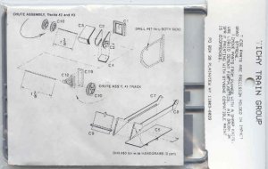

Can some one illustrate or tell me how this coal chute goes together? This kit is a pain in the rear. The print is horrible.
philip:mad:

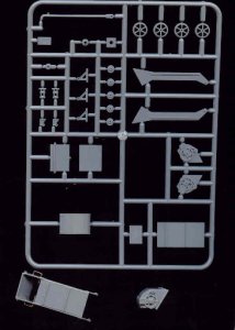

The chute and gate actually assembled with no problem. It seems some of the parts are missing. Should the kit have counterweights to operate the chute? Any pictures out there would be helpful !
thanks again,
philip:)

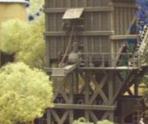

Phillip,
My modules are at the library, as part of program there, so I can't get to the coal tower to shoot a new pic. I had this shot, and was able to "zoom in" using my photo program, so it's not the clearest picture.
The chain, at the end of the chute, goes up to a pulley, and down to the counterweight (the little discs on the sprue), you can see them just above the gate assembly. The pulley is on the shaft, under the small awning style roof, and is operated by a long chain, and large pulley, left of the roof, that chain hangs down to where it can be reached from the tender, by the fireman.
Just to the left of the gate assembly, you see another large pulley, this is also chain operated, and the shaft goes to the gate.
Hope the shot is clear enough to see how I set this up, you can use any variation you chose.
Pete
