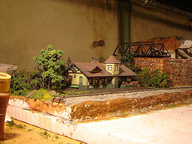

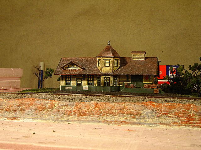

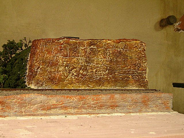

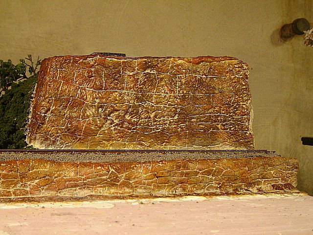

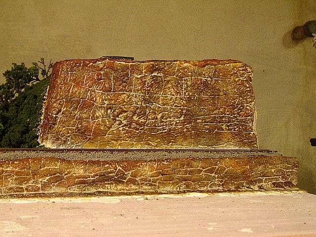

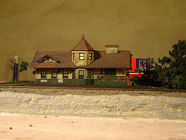

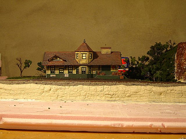

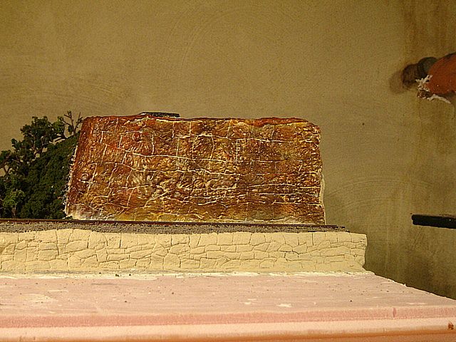

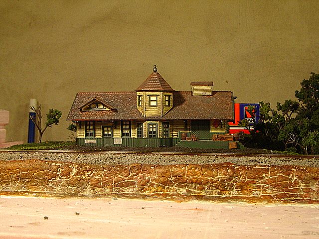

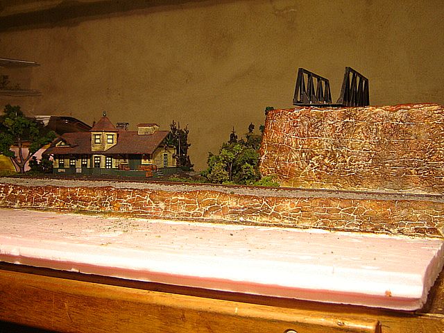

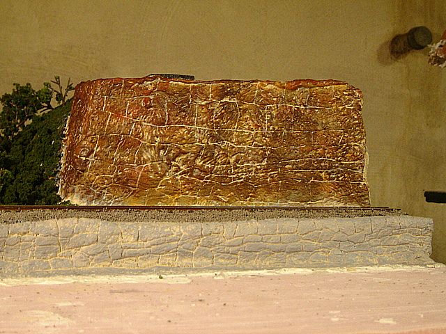

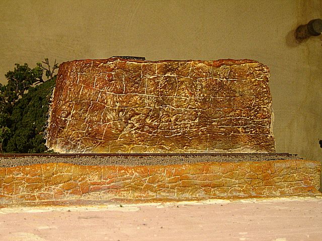

Next using the same method as I used on the abutment I recolored the creek wall.
First I painted it with Folk Art Linen

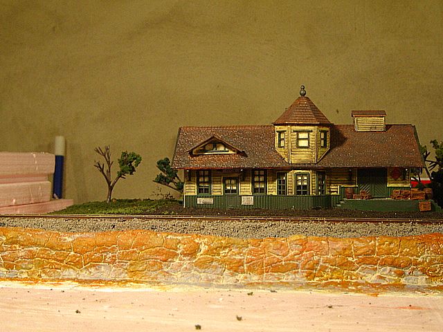

Thanks guys.

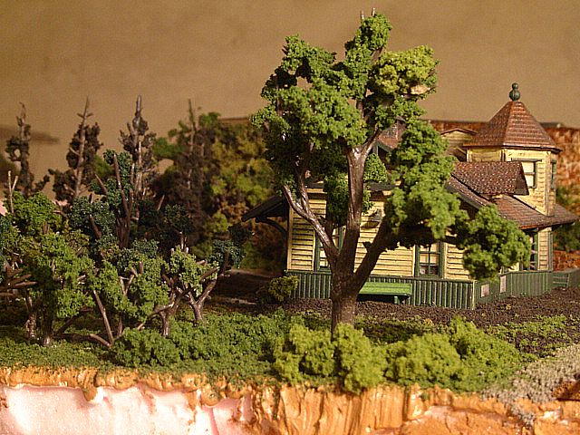

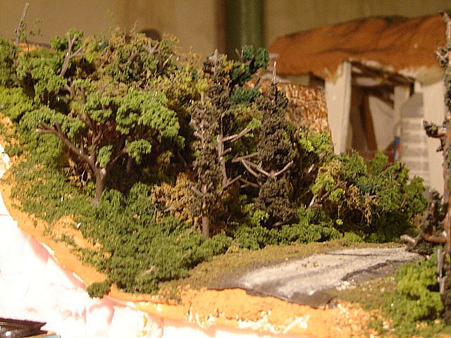

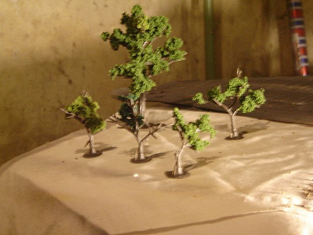

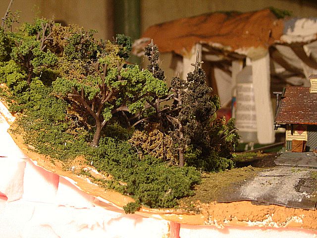

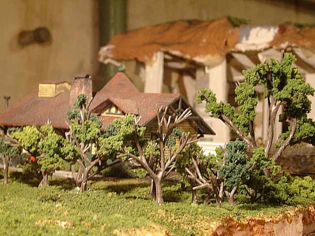

I continued my tree planting and foliage laying. This time I worked on the area along side the station. I still have more foliage to place in and around the trees.
Here is the next area to be worked on.

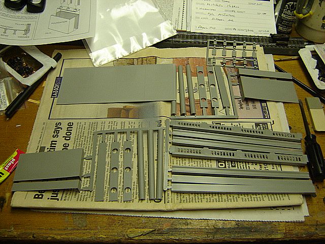

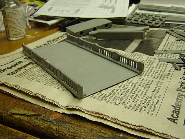

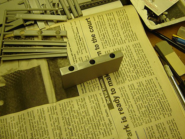

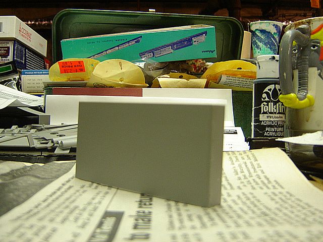

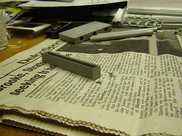

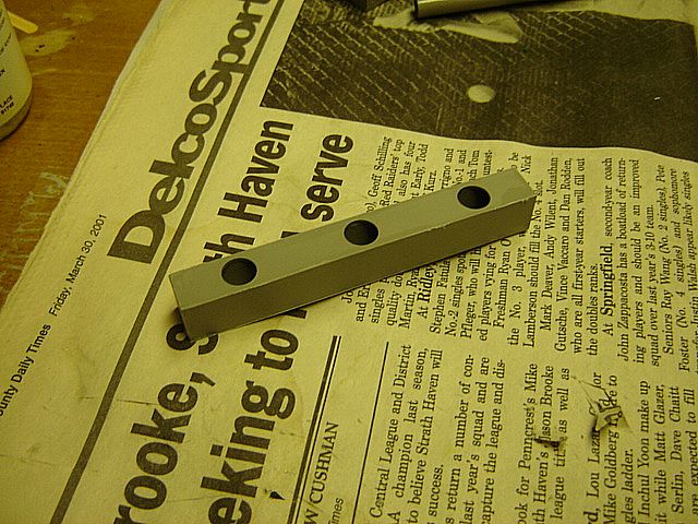

I am beginning to work on the highway bridge. It is a kit made by Rixx.
Here are all the parts laid out.

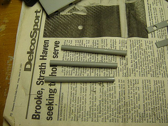

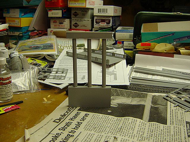

I have begun to assemble the pier. Here is the foundation. I am planning on painting the pier after it is assembled. The parts didn’t want to stay on the spurs so I figured to go this way with it.

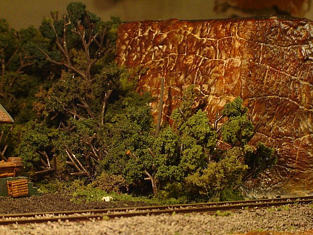

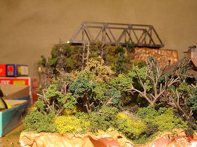

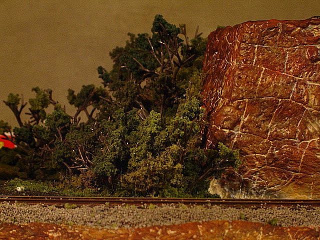

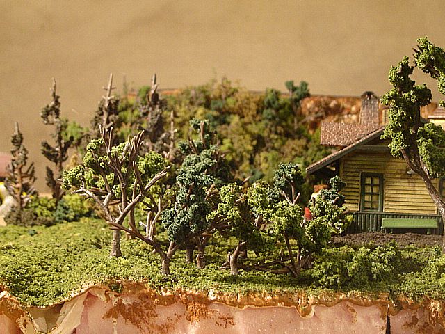

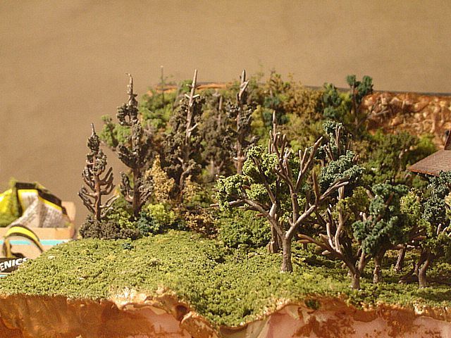

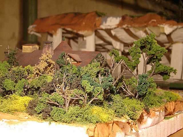

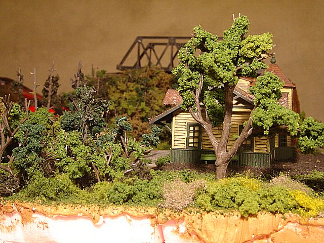

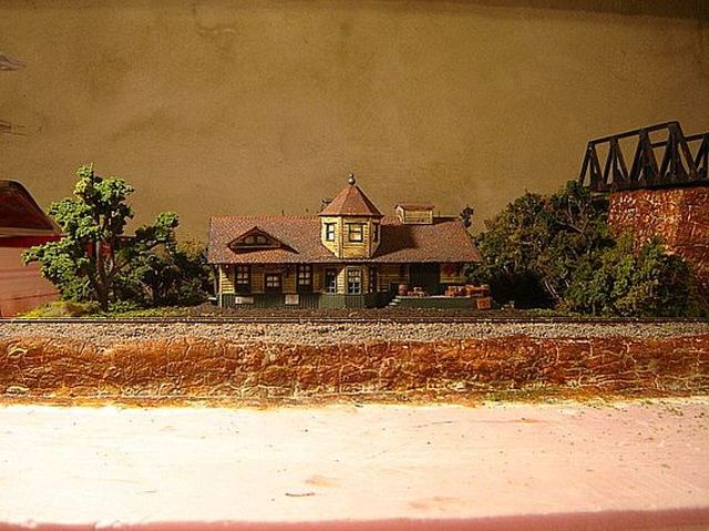

Back to the diorama itself.

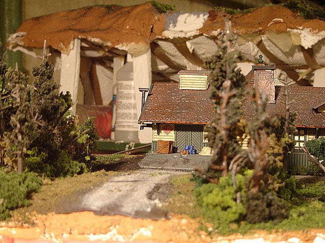

I have pretty much finished the foliage. I add foliage, fine leaf foliage, and clump foliage to the trees along the side of the station.
I also completed the last section
