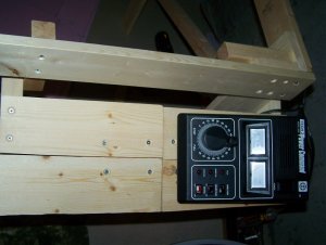

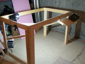

Well I finished up my table and added my new controller. here are some pictures.
Next I will adding the pink foam to the top and planing the placement of the layout.

steamhead
Apr 16, 2005
2,360
Brownsville, TX
Hey McB....You might want to put another set of cross-braces on those legs (so they make an "X"), and add a couple of 1x4 stringers across the top to lay the foam on. You don't want the top sagging under your weight as you work on the railroad....
Goos luck..!!

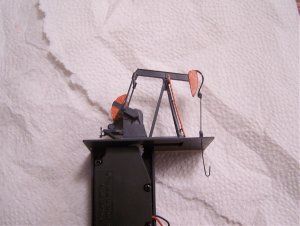

Well I started to Assemble my PumpJack.
Made a few mistakes but I'm ok with it, I used the gel style glue instead of the liquid and this made a mess of the fine details.
I also didn't mix my paint well and will need to sand it down and try again.

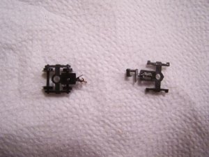

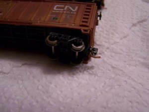

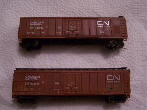

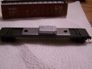

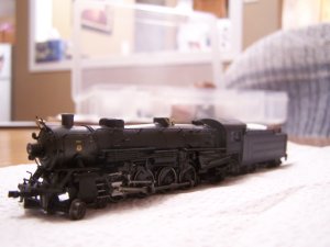

I did some Upgrading of my Rail box cars tonight.
I added Micro Train's roller Bearing Trucks with couplers.
Switched out the plastic wheels for Atlas metal ones.
Added some Weight.
And tryed some Weathering.

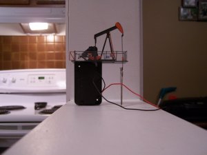

Well I got the PumpJack finished tonight.
I tryed using 12v but the jack ran to fast to be realistic, I found that 3v was about right.
I would place video up but the wire is a little bent and cause's it to run a bit rough. It is getting better over time, so hopefully soon I can add the video.
Let me know what you guys think.announce1
