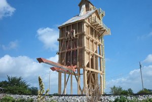

    You can always scribe your own onto Basswood sheets like I do. Here's a coaling tower I built that way. It's easier IMHO to get wood to look like wood. This is HO and scribed with a small phillips screwdriver. Fred

    Blake Member
    Jul 19, 2002
    446
    Fred, that is one beautiful coal tower. I prefer to work in styrene because it moves along a bit faster. However, I built a gang of O&W caboose kits recently that were laser cut wood. I found that by coating both sides of the wood components with Krylon crystal clear kept the parts from warping when painting and allowed me to use ACC during construction. This sped up the process and gave me a whole new outlook on building with wood.
