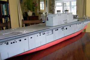

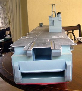

Wet dock doors
Added the wet dock doors and winding housings plus the aft hanger lift section fits together quite well. Not much detail on the lift platform underside could not any photographs it's pretty dark in there just shows as a black hole.
Last pic shows John's flight deck quite well just a fluke the deck plates looked flat without being glued.

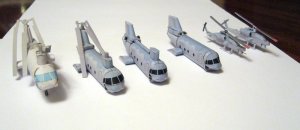

CH53e fuselage
Updated and properly scaled CH53 with CH46 for comparison. 160gsm paper needs another former in the top fairing maybe the 8th one will look good hopefully.

ch53 blades
Like a big insect basking in the sun parked rotor blades this is a complicated system which this current model does not capture properly the rotor head has some very thin joints which enable the blades to park but are too weak for card.
We shall see if it can be simulated

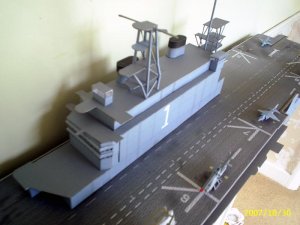

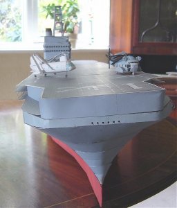

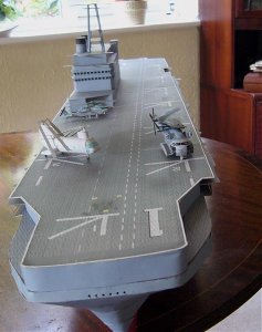

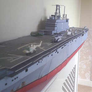

Deck glued
Not sure whether to blow a fanfare of trumpets or sit down and take deep breaths and take the pills but for better or worse it's laid and it looks reasonably flat needless to say the worst joint I have made is in it, tastefully covered in choppers.
John in real life and on a good sunny day it looks twice as good as this, a spectacular job you did there mate.
Still a lot to do and bits to reglue etc and what seems hundreds of life raft containers and I think 24 choppers and 8 AV8a

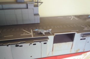

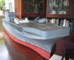

AV8a
Quite pleased with looks of the AV8, shape is such you can get away with a lot sorry no closeups my borrowed camera is not up to it. Added some rolled cigarette paper lattice work to the masts and built the forward ops cabin which is held together with selotape sticky side down as glazing lets you cut the thin top bars.

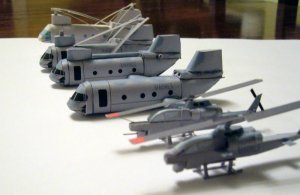

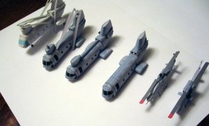

Chopper line
Ch46 production line it is sort of evolving as I go along got to do something more with rotor heads.Takes 5 formers to hold the fuselage straight in the CH46 and a build time of about 6 hours I'm getting slo these days.
