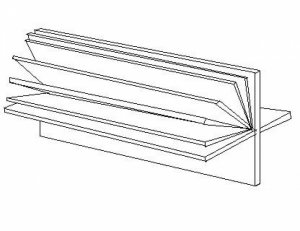

    I think that I'm being dense here. But I don't think that I'm quite grasping how you are filling between the formers. Are you taking multiple wedges of balsa and gluing them in, or are you taking thin(ish) strips, say 1/8 to 1/4" and gluing them in?
    I've seen other ship builders use expanding foam (it's the DEVIL!) as well as closed cell foam and even florists foam. But they either spray it in in the case of expanding foam (Yes, it really is the devil) or they cut blocks to fill the voids.
    Thanks for clarifying this as it will help with both my U-boat and Campbeltown/Montgomery builds.
  2. Zathros
    Zathros Guest
    I got the impression that he us using blocks and squares of balsa, then sanding them to form the bulk of the shape which allows for a greater surface to glue onto, and a much heartier model. I only say this as I wish to hear Treadhead's answer to see if I am close? :)

    I start with strips of card or card board on the underside of the hull form working my way out to either end. This stabilizes the form from the bottom and starts the stiffening process. When I get out to near the ends, usually to within three or four sections remaining, I switch to balsa wood pieces trimmed to fit in the section spaces and sanded down to match the contours of the hull at those areas. With the bottom stable I move on to the top using more balsa wood blocks to be able to easily sand the edges to match the hull profile and deck shape, usually a little bit of camber is on the deck plates to allow things to drain off properly through the scuppers. Once all this work is done I plate the hull starting with the bottom plates, moving on to the hull sides and then to the decks. I can then handle the hull without fear of denting the sides or bottom in because it is no longer a hollow shell.
    As I work my way through the model you will get to see what I am doing. It is strictly personal preference in doing it this way mostly because I like to handle the model, looking at this angle and that as I work on it. When I first started making card models, I worked on the IJN Akizuki, one of the most gracefully shaped Japanese Destroyer hulls, got the hull all built up and then promptly dented the hull handling it. I keep it sitting on top of one of my book cases in just that shape to remind me of why I do what I do with these things.wall1:cry:

    Ahh . . . I think I understand what you are doing. Does this accurately depict what a cross section would look like with the cardboard strips?

    Hi vb,
    Yeppers, I do believe you have it.:thumb:
    As I said, I picked up this way of doing this from the guys on a German Card Model site. The added formers inside to help stiffen the structure and it works amazingly well. All of the ship models that I have built up like this have hulls that are more durable than any of the styrene models that I have built in the past, and there are a ton of those.
