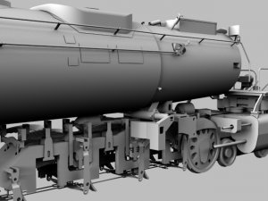

    FRONT ENGINE SECTION

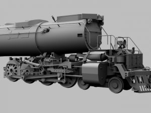

    I return back to designing and adding details to the engine. I drafted 3D model since last year. Now I am turning all parts to be a paper model. I have to add the paper thickness to each part. And design how to assemble them.
    For the engine I want to sprit to 3 sections. Front Engine , Back Engine and Boiler. I start from the front engine first. This section included with Engine Truck , Front Engine. Most of parts are ready to be unrolled.

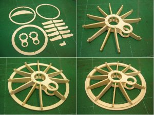

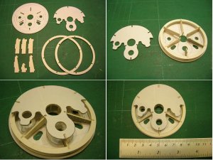

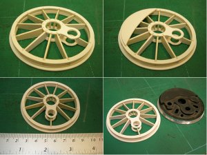

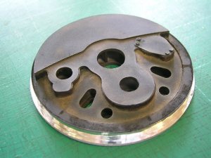

    First part which i want to try building is wheels. They are rather complex shape to be build in paper. My first try was faild in a few days ago. Here is my new design and try to build its internal frame. The frame building is going nice. I'll try to skin in next day.

    I'm back to the long journey again. The wheel skinning process is under testing. Not finish yet.

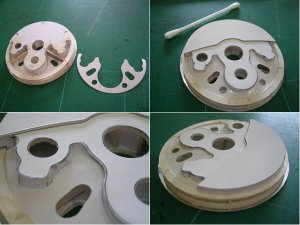

    Thank you Tony

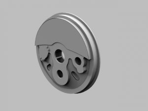

    I finished the test build of Main Drive Wheel. It works well. There was some gap between surface and surface by cutting and bending errors. I repaired by adding big volume of glue to those gaps. And removed the exceed volume by a cotton bud. Those gaps were completely removed.

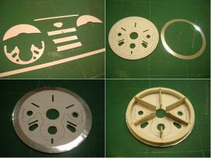

    Hello there , I just finished cutting cardboard pieces of another kind of drive wheel.
    The frame position is quite well fitting. I tried without glue. Parts connection is very strong.

    That's awesome.. Glad to see you back at it again. How did you do the 'chrome' around the driver? I know you can get chrome leaf material for doing cars with?

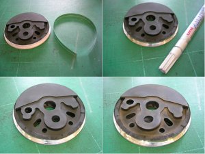

    671
    I cut a gift wraping sheet like a ribbon. Spray glue on it and wrap around the wheel.

    224
    Very cool. I should think aluminum foil could do the trick too. Gift wrap has a bit more stamina though and take the handling/movement a lot more.

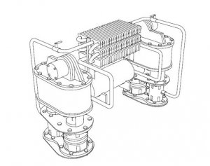

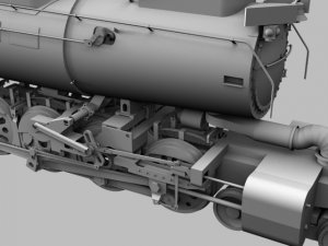

    I redesigned the side rods and all links behide the cylinder.

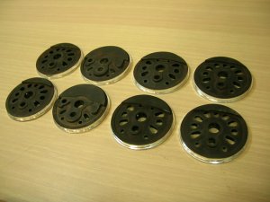

    Finished all front drive wheels.

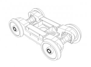

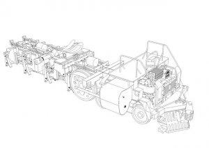

    I was redesigning almost all parts. Added details to chassis , brake , suspension. All parts are ready to be unrolled.

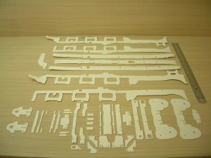

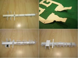

    Unrolled chassis parts.

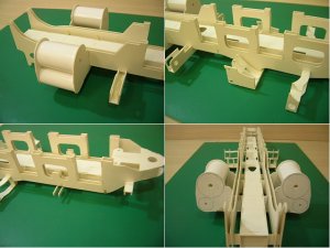

    671

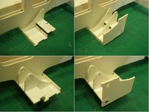

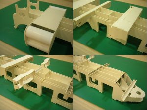

    Building front engine chassis
