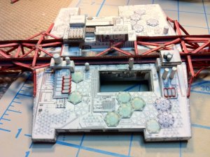

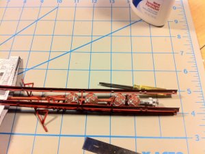

Hiya, I have finished the Model! :) I am so pleased... Um, I did take some artistic license in a few areas, added a lot of little pieces... Say, it was just refitted for the domes and not all the deep space engines, fuel tanks were refitted for close to earth maintenance... It takes a bit to add files, time, so I will add as I have, time... :) Thank you again Uhu!!!!!!!

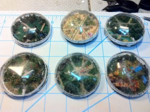

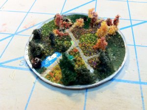

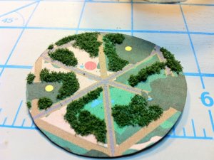

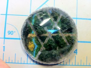

The dome were very difficult indeed. I tried glue, super glue and the tape, he was right though, I finally got some double sided tape and along with pre-taping the dome slats together above the corner where it would be clamped between the inner and outer ring, then using the double sided tape once I had the form, I did OK. But, cutting the forms so that the slats would meet up properly, well...

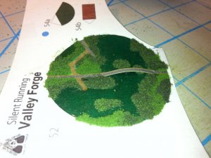

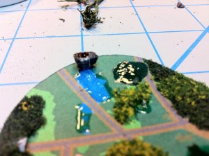

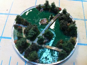

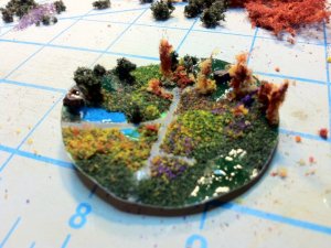

Making the waterfall was fun :) Nothing like the movie, but, at least its there...

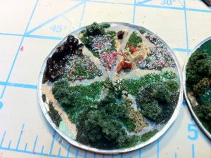

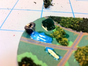

I wanted to show some of the other domes before the, well, domes went on... hehehe
I also added, which I read in many places on the net was a point of discussion, the access ramps... In the last one, you can see it up next to the rocks in the upper left... I figured they used elevators as what they do in the movie just didn't make sense. Thinking back, I shoulda put them in the center, but at least I did try to line them up with one of the main struts running under the dome... And, I know the scales are off, but it was a lot of fun to do!!!

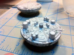

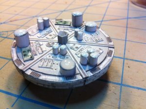

I have been for some time been printing double or triple copies so I could cut out parts and raise (sometimes lower) them for more depth... well, I loved the way the artificial water looked and noted it had the surface tension effect, so, I used that at first with glue, then with the liquid water to make depth to the tanks and other structures on the model by creating curvature to the parts... After I got it somewhere close, I painted them white... too white tho, later i used a little black paint to try and match the space worn look of the rest of the craft... A lot of work and a lot of fun :) Came out ok I think. Later, as you can see the hex structures on the surface of the ship I gave curvature and then placed another thin paper print over the curve to give great appearance of depth, this really turned out well! Oh, I also added more tanks to the bottom of the domes and the ship surface as well, again, either using extra prints or parts from other models...
It is Uhu02's attention to detail that pushed me further! His work is an inspiration!!!
