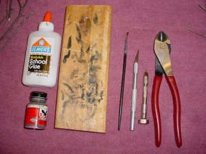

2. Here are the basic tools you'll need for making the trunks:
diagnol cutters or wire cutters
pin vise and bits
exacto knife
paint brush
board with holes drilled to hold trees
white glue
paint brush
paint (I use railroad tie brown)

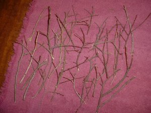

4. Have an assortment of small twigs handy too. These will be used to fill out the tree trunks to make them more like real trees. You will need some straight ones, but little tiny forked twigs are good too.
Around here, we don't have too many species that have a nice three dimensional forking structure on the small branches. I hear that sagebrush is really good, but we have none around here.
Most of our species fork in only two dimensions. We'll just have to do a little more work then.

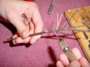

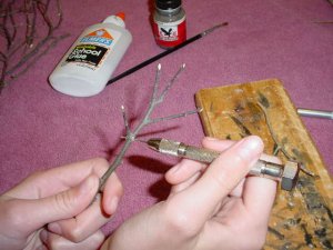

6. Next we will use the pin vise to drill a hole in the trunk so we can add another limb. Use a drill bit that is quite a bit smaller than the trunk itself so not to compromise it too much. Wiggle the bit around a bit to create a tapered hole, but be careful not to break the teeny tiny bit (oops). Drill the hole all the way through the trunk.

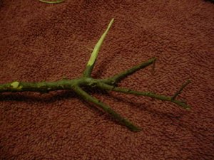

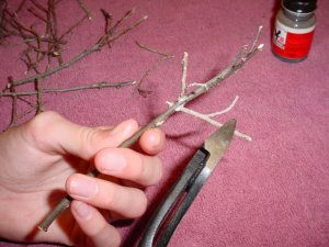

7. Pick out a small twig and trim the end so it will fit in the hole. Sometimes use straight limbs, sometimes use limbs with forks. I tend to use forked twigs for the most part, just to provide more limb structure with the least amount of drilled holes.

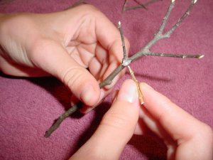

10. Drill more holes to add more limbs to fill the tree out. Work your way from the bottom up to the top, adding more limbs. If you are lucky and have species with good forking characteristics, you may not have to add any limbs at all, sometimes maybe only one or two. In this case, we will add 5 extra limbs to get a good three dimensional structure.

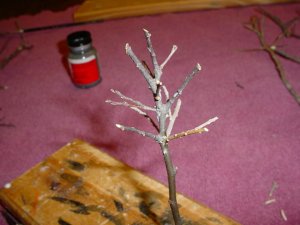

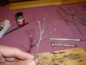

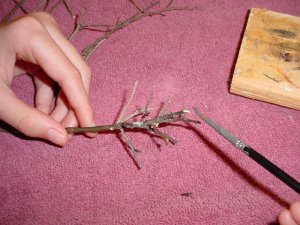

13. The ends of the limbs where we cut them off will be very noticeable. Paint them with some brown paint, also paint around the holes we drilled, cover up any light spots that will stand out like sore thumbs.

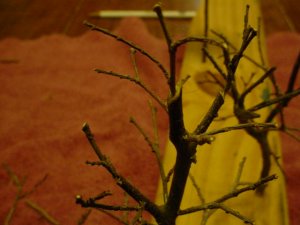

Before we add the poly-fiber, there are a couple of other limb techniques we can use, primarily for tree trunks that have limbs that are a tad too big.
One thing we can do is cut it off fairly short, then drill a hole in the center and add a smaller forked twig to it. Then the larger part of the branch can be tapered down, or it can be filled with putty or JB Weld or something for a smoother taper.
This technique works well for tree tops like in the photo... still needs some carving or some putty.

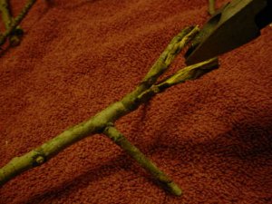

Gary S.
Oct 13, 2005
1,576
Texas
One more way to deal with those husky limbs is to just shave the diameter down to something smaller.
Of course, with each of these techniques, we need to paint the exposed inner part of the wood.

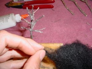

Time to get back to that tree we were working on. Next part of the process is to add poly-fiber. You should be able to find this at the LHS, or on-line. Now, in my opinion, it is critical that you get the black poly-fiber, not the green stuff. The black poly-fiber looks tremendously better than the green, it provides way more depth to the tree and is much more realistic. My first three or four trees were done with green... after that, I strictly use black, and would not even consider using green for trees.
Starting at the bottom, we will add poly-fiber one limb at a time. Yes, it is time consuming to do it a limb at a time, but it will give a much better looking tree than if you just gob it on.

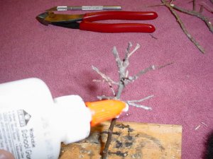

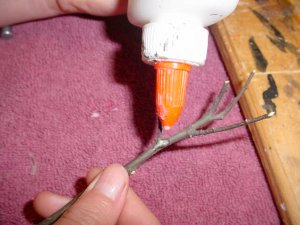

14. Put some glue on one of the lower limbs.
Gary S.
Oct 13, 2005
1,576
Texas
16. Place the poly-fiber on the limb by kind of stabbing the limb through it. Make sure it gets into the glue, maybe even twirl the fiber a bit. You want it to be glued to the limb so it won't fall off when we start adding leaves. Spread the poly-fiber out, all nice and fluffy, make it thin so the tree has a nice transparent look to it.
