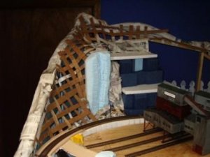

There are quite a few ways to do it. One that many people (myself included) use is the cardboard basket-weave method:
After shaping, cover with plaster-cloth or strips of newspaper or papertowels dipped in "soupy" plaster. The tunnel interior can be made out of what ever is handy: cardboard, styrofoam, etc painted black.
I hope that helps

Great idea!...I bet the plastic version would work pretty good as well with a little extra support. By the way...the rest of that thread is well worth reading:thumb: :thumb: :thumb: . That is some great modeling there! I need to go back through the threads from a while back...no telling what other gems are out there!
The thing which sold me on the aluminum ( I never got to the plastic) was, after it was set in place, I could still make minor adjustments, to shape the terrain, before plaster was applied.
