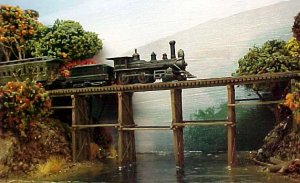

This is my first attempt at scratch building a timber trestle...
I also wanted to try modeling some water...
So I built this little diorama to kinda get a feel for it...
(I know the trestle looks kinda rickety, but I based it on an actual photo taken in the 1890's on a C&O branch line)

Thanks for all the kind words, everyone!
Tyson,
I made the "water" by pouring a soupy layer of plaster, to make a smooth surface...then I painted it with some flat black acrylic paint. Then I feathered earth colored paint from the banks, out toward the middle, leaving the blacker areas in the middle to represent "deeper" water. Then I covered everything with about three or four heavy coats of acrylic gloss medium.

Like all who've already said so, it really is an excellent scene, Charlie. There were some pretty spindly trestles and other bridges back in the 19th century. One photo I have from the Oregon and California (later part of the SP) is a couple of really large logs, perhaps 3 or so feet in diameter, laid side-by side, spanning a fair distance, with tracks laid right on top of them. And this was "main line" stuff in the 1880's, not a back woods logging operation. I really want to incorporate that into my new layout.
Does your water look as good in person as it does in the photo? That's the way it was done prior to the introduction of all the poured plastic techniques, and frankly it appeals to me more than the "modern" way. For water I once painted and varnished a chunk of Masonite about as you did the plaster, and I though it turned out close to perfect.
