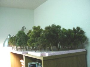

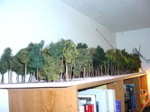

When I started 2 years ago, before I had a track plan and all that, my wife and I made about 250 trees because I thought I would need A TON of trees. But then my ideas morphed into an industrial type layout, so now I don't need that many trees. At least I think I don't. I have a couple areas that will have trees, but that's it. Right now, the trees are stuck in foam sheets and sitting on top of my bookshelves in my work room. I need to take a pic for you.
At times, making 250 trees was a pain, but in all, it was fun. The best thing is adding the foam, because that is where you see the finished project.
If you need a bunch of these, try to enlist some help, it really makes it go faster.

Here are some photos of all my trees, still waiting to be placed on the layout.
