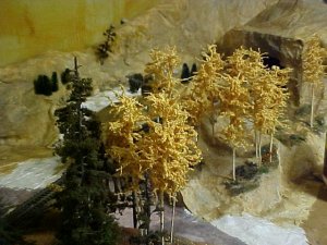

Another Tree Gluing Problem
Hey Pete, May I impose on you for some advice?:D
A couple of years ago I got on a "bender" of making Aspen trees and was using that 3M Super 77 Spray to attach paper punches to the tree armature to make leaves.
Wondering if you ever ran into this problem with it......It has never dried or set:eek: To this day its still tacky and I dare not let the trees touch each other or they will stick together.:eek: :D
Any thoughts??? Maybe I got a bad can of the stuff:eek: :confused:
