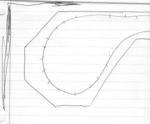

You dog bone the ends so that you can walk around the ends which will keep the max reach managable but allow you to use fair sized curves, excuse my crude drawing, but i'm a MRRer, not an artist. Fred

Great suggestions I like the drawing and that is a great idea to bell out the end. What radius is a good minimum to count on for the end curve? I was also looking at the Atlas Super Pretzel with some of my own modification. Is Atlas good track and which of Atlas' track would be best. I hear nickel silver is the way to go, is it better to get the track with the base already on it?

On curves, the bigger the radius the better. I use 36+ inch radius, but I realize that's too big for your application. I would at least use 24 inch or greater. Atlas track is a good modest priced track that can be purchased almost anywhere in code 100. Code 100 is bigger than prototype, but you can run almost anything on it. Code 83 is more the right size, but is a tad more expensive and some older "big flange" stuff will not run on it. Nickel Silver is the ONLY thing to use, esp. if you have to buy track. The old brass track is hard to keep clean. There was also some galvanized steel track made at one time. I also avoid it. Look into flex track. It's what I use and is easiest to build a fleelance layout from. No more worring about fitting and sizing, and you can make your curves gradual (easements). Walthers track is also good, Peco is great. Good turnouts have a metal frog which allows better running at the expense of more work wiring it up initially. Insu frog are... accaptable but expect stalling, lower quality look, and the plastic frog wears out. Track, the rule of thumb is the more it costs the better it is, really. It's not a name thing, but actual quality. Fred
