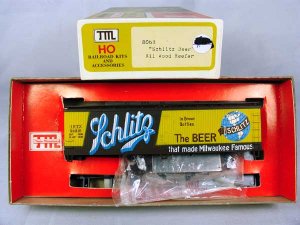

What is the experience with Train Miniatures? Specifically, I have the chance to buy a large lot of reefer kits, in the box, but am unfamiliar with this brand (thought I knew them all!)
Picture attached for reference.

Kris, Don't feel bad, I have never heard of them either. I don't really know how picky you are but I don't recall Schlitz ever having a reefer that looked like that!

I have been selling a large collection. There are many Train Miniature models. There are a number of Schlitz reefers. They build out quite well. A good looking product for the money.:wave:

I have a handful of them myself. 3-12 car blocks to be correct. They build easy. If I didn't know any better, they build as easy as the basic Athearn kits. I bought my car's at a show about 6 years ago at a good deal price of $2.00 a car still in the box, never opened. I had been looking at them for the past few shows prior to purchase and they weren't selling and the guy wanted to get rid of them so he said if I buy 10 or more they would only be $2.00 each and I figure they cost about as much as a basic Athearn kit so it was I deal I couldn't pass up sense I was on a reefer frenzy anyway. I'm slowly gaining a stock pile of Kato trucks to replace the old ones but won't get changed until I have enough trucks to replace all three blocks. I say go for it. You never know but you might end up with a hard to find collectors car out of the deal.

Ray is right: very similar to Athearn but with some style variations. They offered several styles of boxcars and reefers with a lower roof line than Athearn's versions, making them suitable for representing some of the cars from the '30's, '40's, and '50's. Like Athearn, the roofwalks, stirrup steps and door tracks are a bit clunky but these details can be easily changed. They made a decent version of Pennsy's X-29 boxcar: I have several of these on which I've updated the clunky details, and then painted and relettered and they are indistinguishable from the X-29 offered by Red Caboose. If you model in the steam or early diesel era, the varied rooflines really help to set the timeframe. I'm modelling the '30's and one of my favourites is the plug door boxcar: by shaving off the door hardware and extending the door track to the left, you can make a very credible door-and-a-half automobile boxcar using cut-down Athearn doors. They made several styles of wood and steel boxcars, reefers, stockcars and hoppers. There were also work cars (bunk, tool, rail and tie car and even a small crane. The original Train Miniature became Train Miniature of Illinois and then was eventually taken over by Walthers, who, as far as I know, still offer them.

I like their kits, easy to assemble reasonable detail and if you use metal wheels and bring them up to weight they run well. Matter of fact I'm looking for a bunch of their gondolas right now. They were bought by Walthers and produced by them for quite some time using the same molds. The only tihing is the unrealistic paint jobs and fantasy cars they put out.I love finding undecorated ones.

Train Miniature = Walthers (sort of)...Walthers bought Train Miniatures in about 1985-86 and began producing the Train Miniature line as "Walthers". So...if you're familiar with Walthers 40' woodside reefer and like them, this is the same kit. I think Walthers' versions had a little bit better decorating, a little bit more opaque, but TM was very good nonetheless. I have several old TM cars on my layout and am quite happy with them. Walthers also did about some other TM cars in their line (I think the woodside boxcar, X-29 steel boxcar, 42' flatcar), then began adding their own designs.
