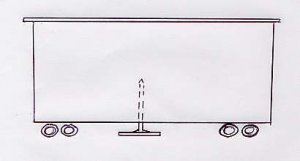

You can make a track cleaning car out of virtually any pice of rolling stock by drilling two holes undeneath it to accomodate nails that are glued to a small piece of masonite that is just a little wider than the track gauge. Use nails with good flat heads. Slip the pointed ends through the car's underbody and let the masonite block float free on top of the track. Hook it up to a locomotive and let the car drag the block over your rails.
Here's a simple (crude! :)) diagram:

greeeeeeeeeat thanks.
just one question: what do you mean by floating freely? i don't want to sound st#@@d, i just want to make sure
Ralph
Remember...it's for fun!
5,134
St. Paul, MN
No such thing as a st#@@d question CN1 :)
What I mean is that the nails inside the car are just poking up through the holes. They aren't attached to anything inside the car. Were you to pick the car up, the masonite block with the nails would fall out. I suppose one could add a fixture to the tips of the nails inside the car to prevent this but why bother? Any way, the block is able to move up and down to accomodate any irregularities in the track but gravity keeps the block on the rail surface. Wish I could claim it was my idea but I'm following in the foot steps of great modelers gone by. :)
Regards and happy cleaning!
Ralph
CN1
May 6, 2003
1,059
Hey! That's a great[er] idea! Way to go...

Originally posted by CN1
Does the masonite pad can "snag" into turnouts or the like??
I think I've seen some designs where the edges of the pad were rounded off so they wouldn't snag so easily. Also, masonite has a smooth surface on one side and a rough surface on the other - I think the rough surface was on the bottom.
