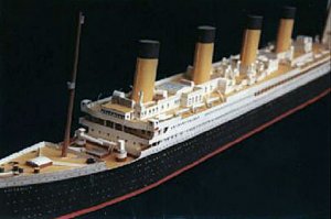

I doubt very much that fading of the colours over time of the Fly Model-GOMIX model would result in accurate-looking colours. For example, what would happen to the already light pink bottom of the hull? Or the dark grey or black areas? Please note in the manipulated photo above that I have made the black hull and the tops of the funnel even darker black than on the original model. I also doubt that the dark decking would get the proper colour.
Colour chips? I think what you mean is; are there RMS Titanic paint and colour recommendations anywhere on the web, around which there are reasonable consensus as to their accuracy? The answer is yes, there is - at the TRMA web site: http://titanic-model.com/articles/p...in Page/WEBPAGE_Paint Reference Main Page.htm
I have to look at Leo Marriot´s card model - I remember having seen the name somewhere a while ago but I haven´t yet seen the model.
Another model which is very historically accurate in the colouring is the Möwe-Wilhelmshavener Modellbaubogen Verlag 1:250 scale model (a waterline model, though, just as the Polish JSC and German Schreiber-Bogen 1:400 scale models) - it is readily available from the publisher in Germany for 42 EUR, here - click 'Liners, 1:250 scale, and go to 'Seite 2' (page 2, or 'weiter')': http://www.papermod.de/D-shop/index1.html
This, I would say, is probably the most accurate model available today, when it comes to historically correct colouring. It is also very detailed for it´s scale - there are 13 sheets for the model.
There is a very nice downloadable 'Modellporträt' of this 1:250 model by expert card model builder Reinhard Lachmann on the Kartonbau.de forum, with many excellent close-up colour photos - check it out here: (added new link, March 31st, to Modellporträt Nr. 36): http://kartonbau.de/wbb2/filebase.php?fileid=42&lim=60&sid=6151e488154c060a5bd3f65d5e024d85
That´s all for now,
/Bengt :thumb:
PS. I noticed that in the photo below of the Möwe-Wilhelmshavener 1:250 scale model, there are no light grey canvas roofs (colour: 'Light Admirality Grey') on the navigating bridge roof top, neither on the two wing cab roofs on either side of the navigating bridge. Please compare with the Davies-Garner model photo above. If this card model is attempted, they should probably be added on top of the planked-coloured roofs. The painted canvas tops offered extra weather protection.
(Correction, March 31st): I have now studied the Modellporträt Nr. 36, mentioned above, and it is evident that the Möwe-Wilhelmshavener model HAS the grey canvas roofs on the two wing cabs. The bridge roof has the planked roof - it could very easily be covered with a thin quadrant layer of light grey 80 g/m2 paper. The well, poop, boat, and promenade decks are bit greenish, at least in the photos, and the White Star Line 'Buff' colour of the four funnes is perhaps a bit too saturated and too yellow - a better colour is more pale and light beige-yellow, not bright lemon yellow.

I guess I knew it would be too good to be true to have a model just fade into a correct shade of colors but a lazy man can dream. Speaking of a lazy man, you saved this lazy man lots of time with all the links you supplied. Good stuff!. Thanks for all the links and particularly paint recommendations one.
I just downloaded the model build up of the Moewe-Wilhemshavener build. I remember it now. I like the scale. I don't like that it doesn't have the full hull. I wonder if the Fly Model hull could be adapted to the Wilhemshavener model? Then one would only be recoloring the one bottom color.
The reference I spoke of by Leo Marriott is not a model but a book from PRC Publishing Ltd; London; copyright 1997; ISBN 1 85648 4335. I would not try too hard looking for it. It was a cheap discount book at the time I stumbled across it. Beggers cannot be choosers here in Zambia for reference material and probably the only reason it was here was because the movie had come out sparking some interest in the subject.
You had mentioned above also about the windows on the Titanic. Looking again at the model I didn't realize all the portholes in various sizes. I then look a look at all the windows on the upper decks. As you said, one could spend considerable time detailing not only transparent windows but then interiors. More challenges.
